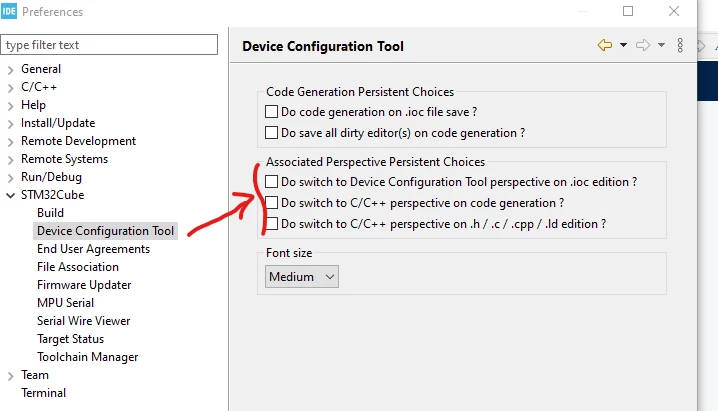

[SOLVED] Automatic switching view for CubeMX file is buggy
when switching from e.g. a C file to CubeMX file, the view is changed to Device Configuration view. This is also the case if the CubeMX file is already opened in the IDE. Closing the CubeMX file also restores the view back.
However, switching to a C (or another) file while leaving the CubeMX file opened doesn't switch back the view. This is a bit annoying, because the view must always be changed back manually.

Windows>Preferences

Hi Cartu38,
that was it! Thank you very much. I wonder why those functions aren't enabled by default.
