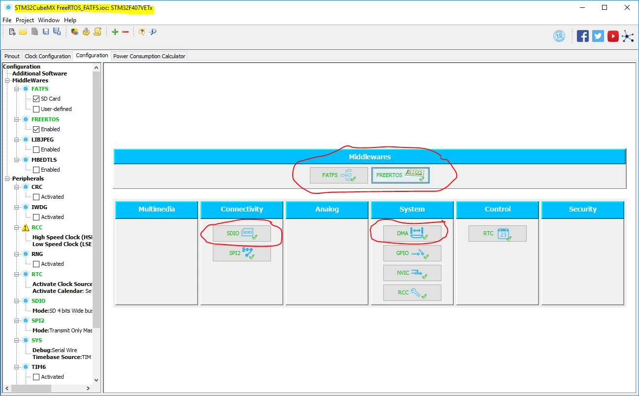

Bardeen LaiBest answer
Feb 22, 2018 6:16 AM UTC
Posted on February 22, 2018 at 07:16

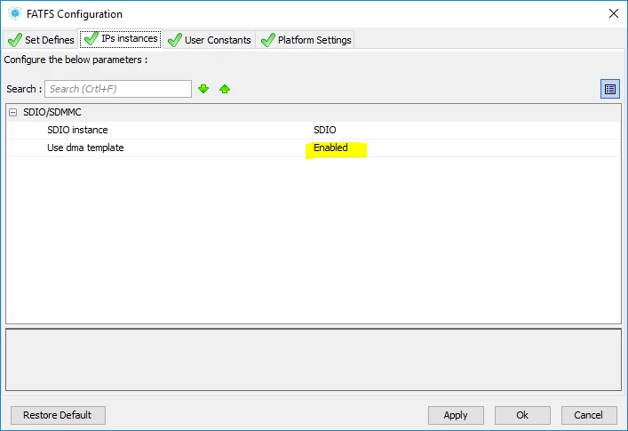

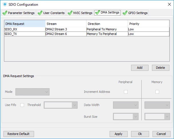

I have tested FATFS by use of DMA under FreeRTOS, it works!
Here is the screen capture of setting STM32CubeMX V4.24
Project Setting:
Make sure FATFS configuration ''Use dma template'' enabled:

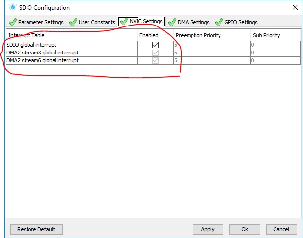

SDIO settings:
Enable NVIC

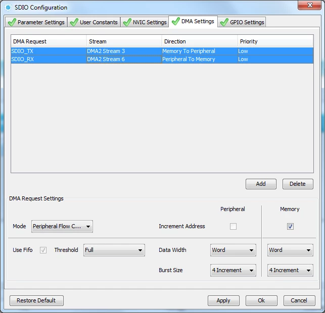

and DMA settings

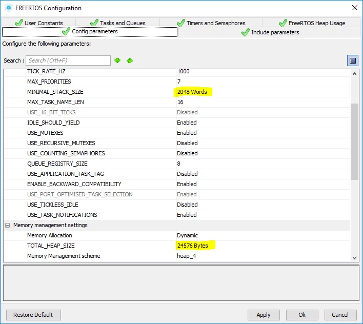

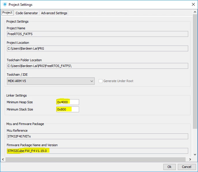

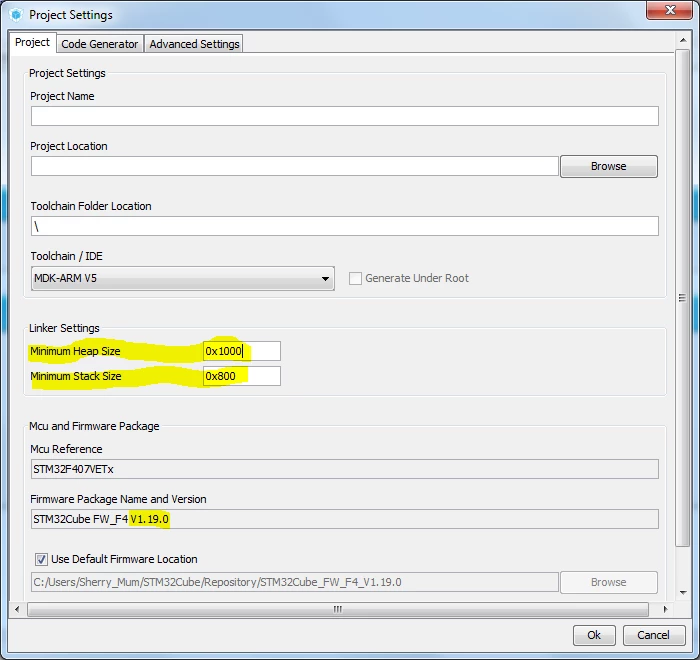

Then, tune the FreeRTOS, stack and heap sizes
After generating codes, you have to modify the following files:

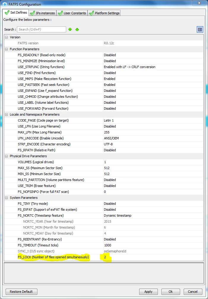

I guess some of you CANNOT mount or open files properly could be one of the following issues:
1. Make sure the project setting of heap and stack sizes are enough, for example
   Heap size: 0x1000
   Stack size: 0x800
2. Make sure the number of files opened simultaneously >=2, please change the number if you open or create files more than 2!
3. If you are going to use DMA, then you have to activate the DMA settings at SDIO
Project Setting:
SDIO settings:
Enable NVIC
and DMA settings
