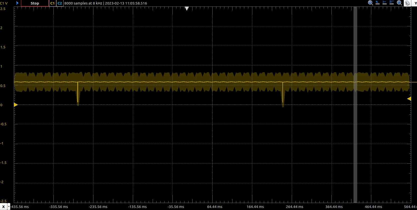

This is what I can see from the USART (theoretically in this image I'm sending "0xFF" all the time, but it does the same whatever I put in the buffer).

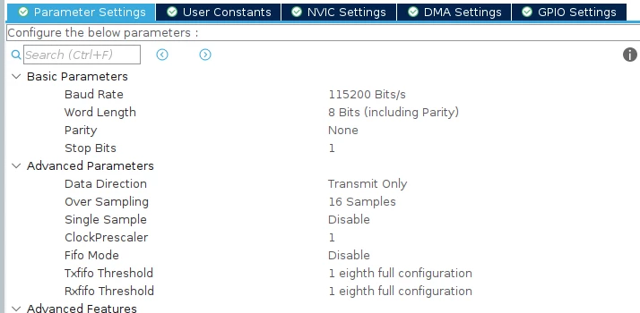

The USART is configured as Half-duplex (as it need to be) & baudrate, word length, etc...are correct: 0693W00000YAaAhQAL.png

EDIT: If I remove the watchdog the "spikes" that go to 0 disapear.

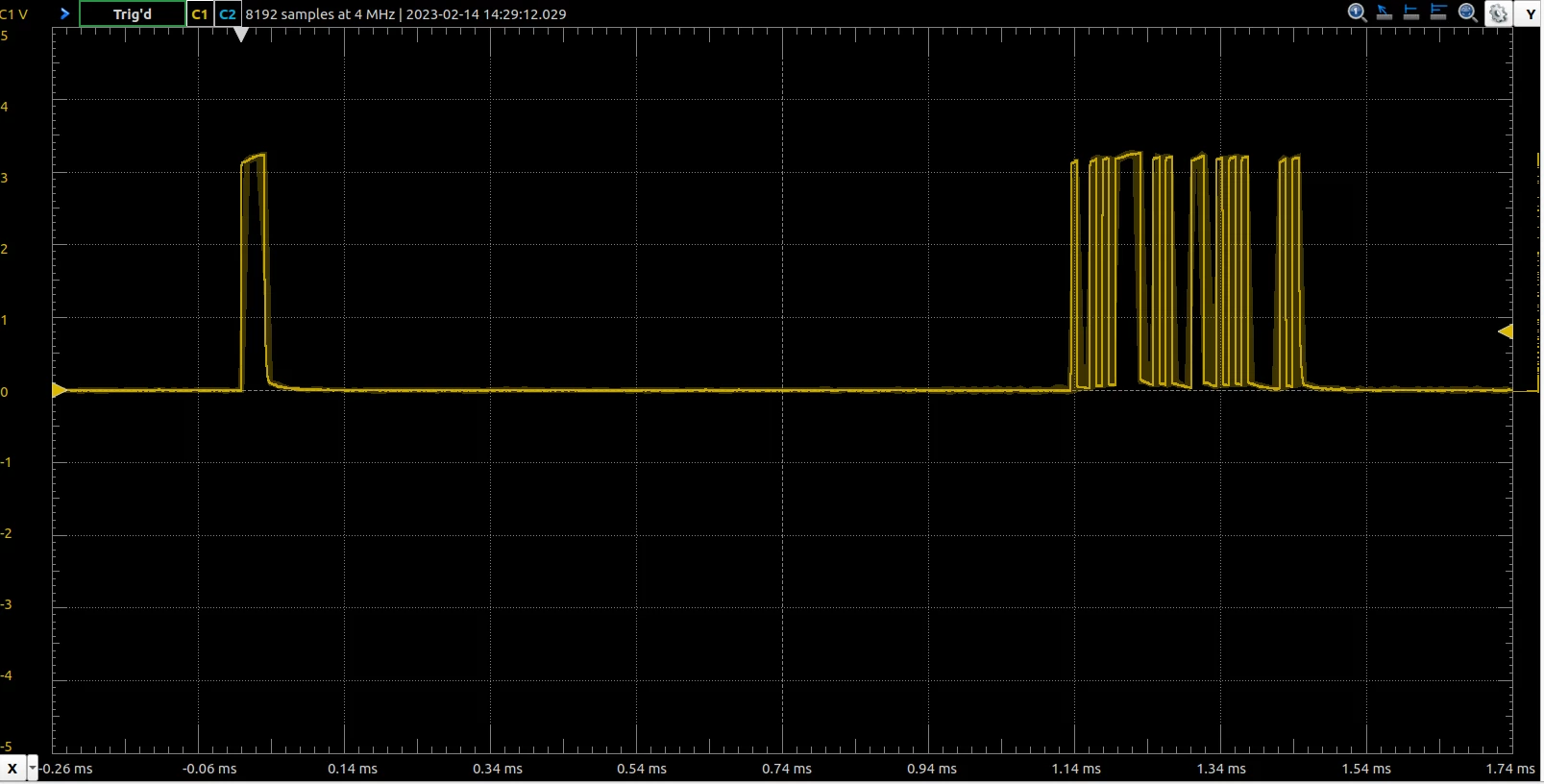

Feb 14, 2023 1:30 PM UTC
Just as a reference, this is what I've got now, it should be saying "HOLA" using the UART with an DMA, I'm receiving other stuff mostly random symbols, I can't seem to find the relation to it:

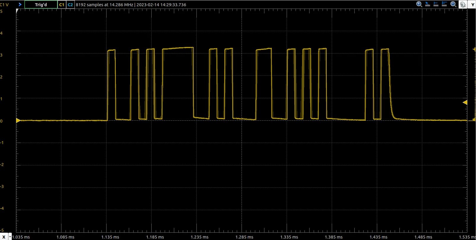

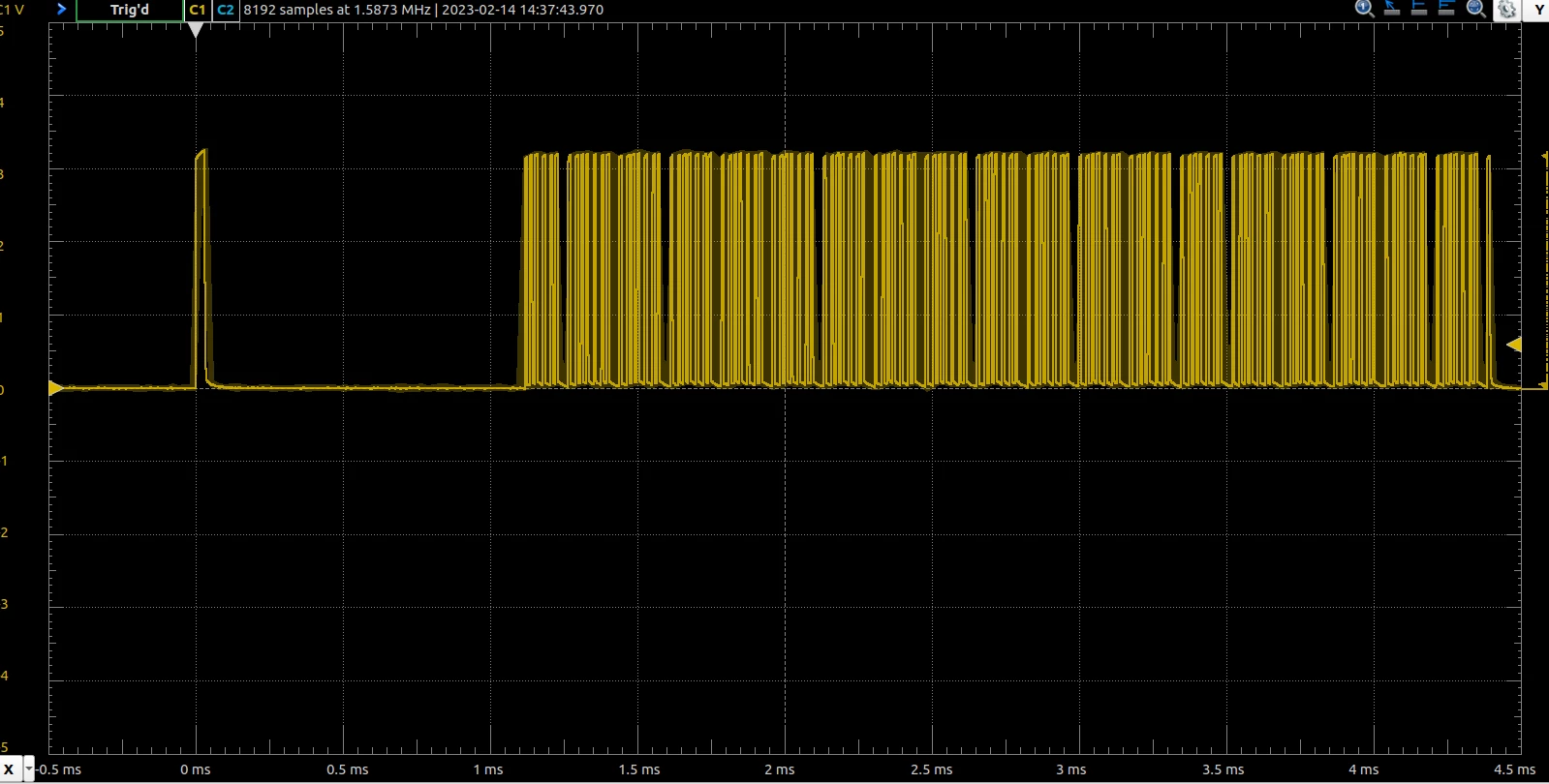

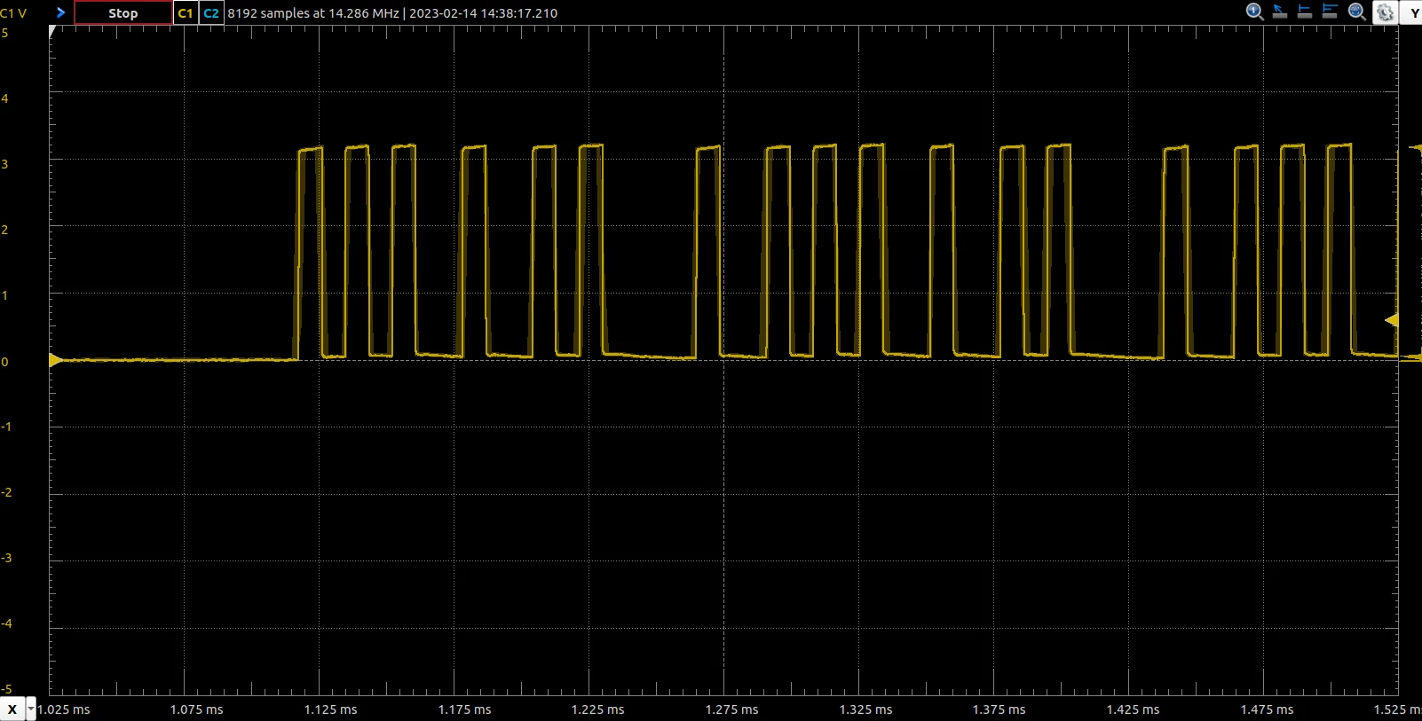

Feb 14, 2023 1:38 PM UTC
Now I've tried to write "*\n* just to have some other signal to compare like the one in this link: https://hackaday.com/2016/06/22/what-could-go-wrong-asynchronous-serial-edition/
It seems that in my case the message keeps repeating multiple times. But the bits are correct:
Bob S
Feb 14, 2023 3:15 PM UTC
Your polarity looks inverted. With TTL/3V level signals a UART should idle high. The start bit is initiated by a high to low transition. These images look like your line is idling low. Unless I am missing something, like you have a TTL-to-RS232 level shifter that isn't able to drive below 0V???? I don't know how that (inverted could happen in the G0, but then I don't know much about the G0 family.

Feb 15, 2023 3:00 PM UTC
Now that you said it...yeah, that's weird, There's nothing you're missing, I don't have a TTL-to-RS232 shifter.
I'm taking a look at it, everything is really weird. I managed to receive signals if I sent messages very quickly and it's very inconsistent, if I had a delay to sent messages every second then it's impossible to make it work and the signal you see it's like the one were talking about.
I don't understand anything.
Maybe it's just noise, what I see now looks like a word, but the characters are wrong. Maybe he's interpreting that the start or stop bit or whatever is in the wrong position.

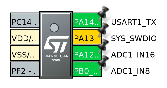

STM32G031C6 has no SO8N in CubeMX.
fancyrat
fancyratAuthor
Feb 16, 2023 9:10 AM UTC
In CubeMX I'm working with STM32G031J6Mx SO8N. I think that both chips are mostly the same.
KnarfB
Feb 16, 2023 11:17 AM UTC
Yeah, the disco board? For your above plots: double-check that you have probed the correct pins. On my disco, I have swapped RX and TX pins internally (CubeMX), so PB6 is free for SWD debugging. Make sure that TX is configured as push-pull PP, not OD by CubeMX.
Its also advisable to leave/config PF2 as NRST (option bytes), so you don't lock out yourself like several people here already did.
