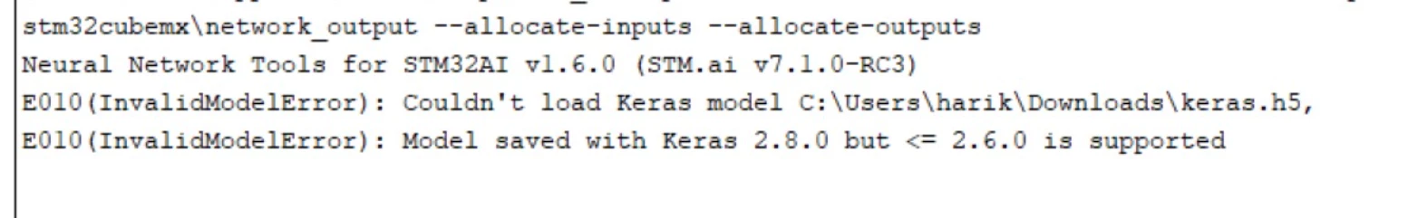

sir im getting error while giving my keras model version.

Support of latest tensorflow / keras version will be part of next version of X-Cube-AI that should be available mid-year.
We also have a integration bug in the 7.1.0 where the supported version of Tensorflow is 2.7.0 while the the Keras version is still 2.6.0 (it should be 2.7.0)
So the best for the moment is to use Keras 2.6 to pass the network to X-Cube-AI
