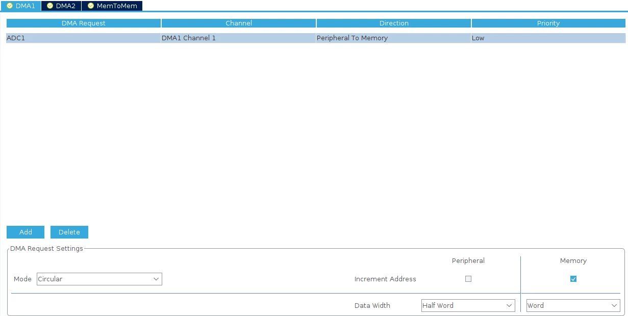

So I wanted to use a single DMA with the Dual regular simultaneous ADC mode on a NUCLEO-L476RG. However I noticed that just the master ADC value was present in the buffer of the DMA, even though the Data width of the DMA is set to Word.
After some investigation, I found that in the file stm32l4xx_hal_msp.c in the function HAL_ADC_MspInit, automatically generated by STMCubeMX:
hdma_adc1.Init.PeriphDataAlignment = DMA_PDATAALIGN_HALFWORD;
hdma_adc1.Init.MemDataAlignment = DMA_MDATAALIGN_WORD;
Changing manually DMA_PDATAALIGN_HALFWORD to DMA_PDATAALIGN_WORD is working, but I wanted to know if there is an option in STMCubeMX to configure that ?

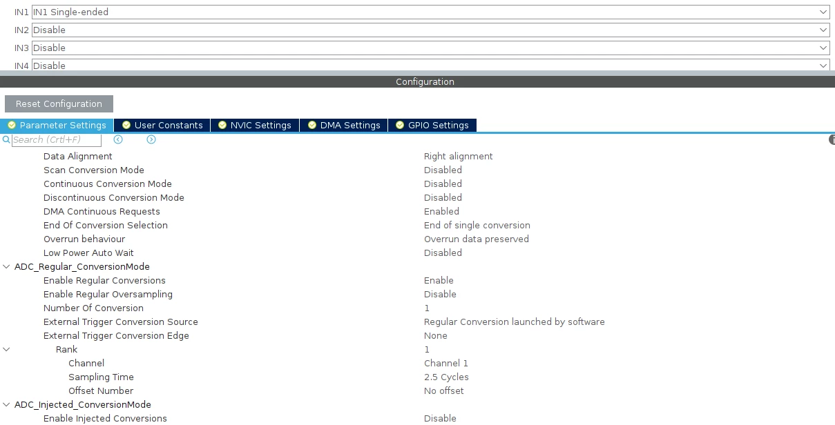

  • ADC Master :

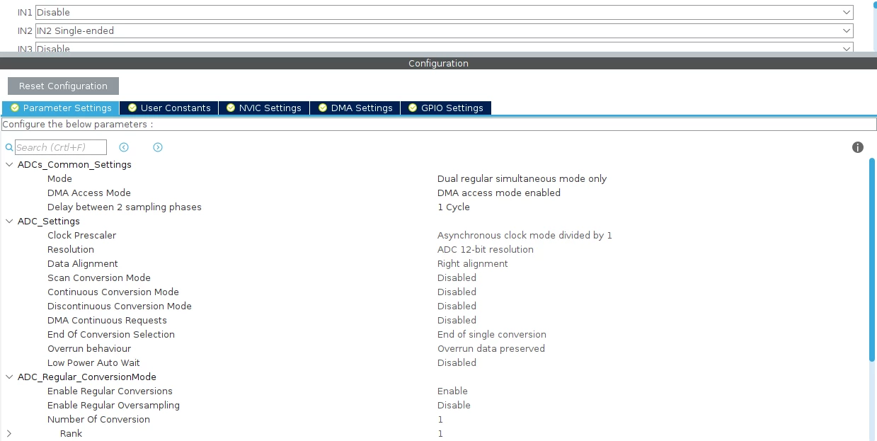

  • ADC Slave :
  •  DMA :

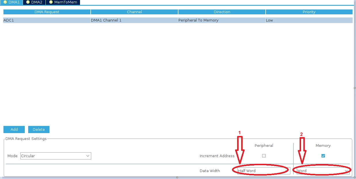

Hello @GDuc.1​ ,
You just need to change the Data width to Word,
Best Regards,
Khouloud
Nesrine.JLASSI
Visitor II
April 14, 2020
Hi @GDuc.1​
PeriphDataAlignment generated in the code is none other than data width for peripferal.
MemDataAlignment data width for memory , configured from DMA table and not ADC
So, the answer is Yes, you can do the configuration from DMA table.
