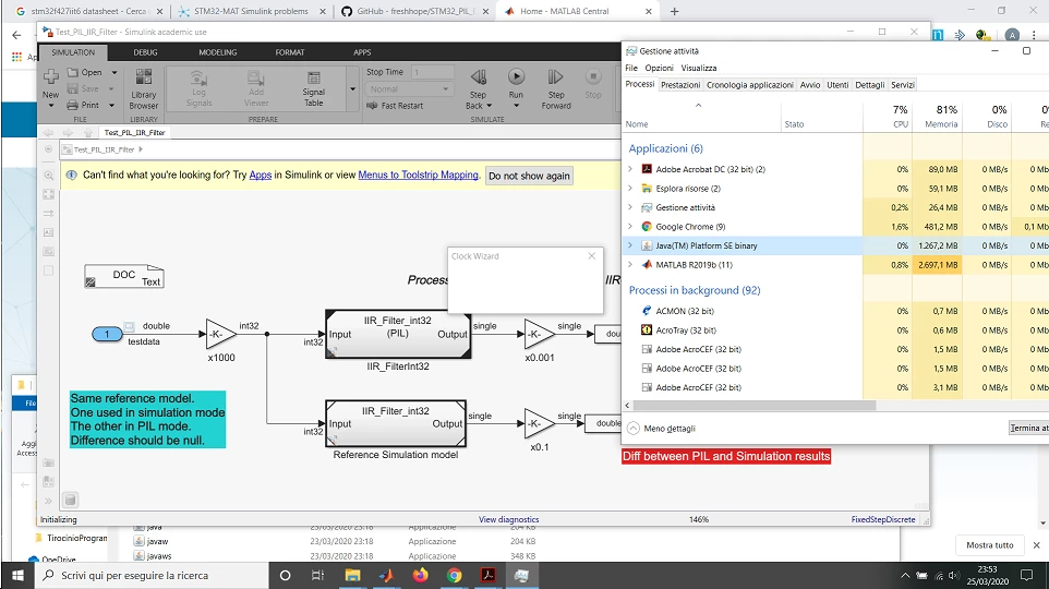

i'm Antonio and few week ago i've start to learn simulink and PIL simulation.
I tring to test the IIR-Filter project from STM32_MAT-TARGET on my stm32f429i-DISK1 board with sw4stm32 toolchain but i've some problems ( used many time all the steps of STM32_MAT-TARGET_HandsOn_v1_0.pdf) but for me the biggest issue is the freezing when simulink try to open stm32cubemx (probably at clockwizard start).
Java not work and only after i kill the process stmCube work, but without the settings...
i've uninstall java with the relative tool , clean registry, reinstalled, killed processes that can use java, but nothing have work...
Someone can help me?
Someone have had the same problem

For all the people that use SW4STM32 toolchain, maybe i've found a solution for the error: The timeout of 5 seconds for receiving data from the rtiostream interface has been exceeded.
System Workbench STM32 open auomatically a connection on the serial port with the board. Do you must disconnect the link with the build-in console, and only after burn the application on the board.
For the java freezing issue the only solution is kill java and set manually the clock and the other parameters.

Hi @toniospritz​ ,
You can perform premilinary checks:
- does starting STM32CubeMx work alone? Create a dummy project for the device you are targeting and verify that the code generation is correct.
- start a basic test with Simulink, from the parent folder C:\MATLAB\STM32-MAT\STM32\STM32demos\Test.
Then you use MATLAB R2019B which behaves differently from R2018B, the version which should be used with STM32-MAT/TARGET v5.6.0.

thank you for the help! I've update from v5.4.0 to 5.6.0 and now cubemx start and generate code.
I build the project (IIR_filter) with sw4stm32 and load on the board.
Now new error :( rtiostream give timeout error...
what wrong procedure i've make now?:sad_but_relieved_face:

It appears that you are experiencing a communication problem with the device during the host-side simulation for PIL.
Have you defined enough heap and stack for your device?
Is your device working? (Stop the debugger and check that the execution is polling the RX path of the UART, if yes, resume execution and start PIL from host side)
Have you checked the configuration UART link on your device (USART instance and corresponding hw pins for this)?

i don't know how is possible, but the issue with java and cubemx is come back! :loudly_crying_face: stm32cubemx stop run on the clock wizard.
For the second question he heap size is set ad default valure at 0x200. How i can check the polling on the rx path?
the uart configuration i think is ok, i've set the usart1 (pin PA10 for the RX and Pa09 for the Tx) i've try to load the usart ioc from C:\MATLAB\STM32-MAT\STM32\STM32demos\Test\USART\F429I-Discovery\USART_1_Receive and have the same iostream error message...
