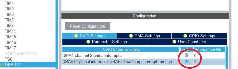

Lastly note that the UART interrupts MUST be enabled... see below...
