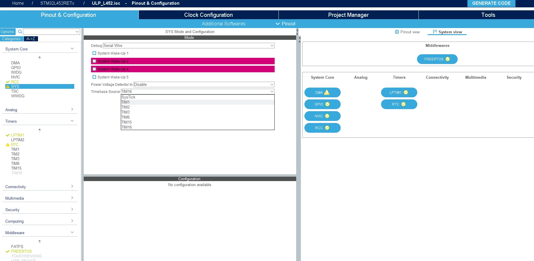

I just wonder why I am not able to set up LPTIM1 as time base for FreeRTOS.
Background: For battery powered applications I often use FreeRTOS with tickless mode and a sleep instruction in the idle hook function. This, allows automatic switching in sleep mode, when there is nothing to do. Perfect,
Problem: When I use a normal timer as time base for my RTOS then I am only allowed to use the "Sleep Mode". But in sleep mode the µC consumes a high amount of power. So I would like to use the "Stop Mode" But in "Stop Mode", the core is stopped and the only oscillators that are able to run are the LSE and LSI.
Setting up FreeRTOS for low-power usage using LPTIM1 or LPTIM2 as clock base is not possible in CubeMX. See the attached screenshot.
Does anybody ran into a similar problem? How do you setup your RTOS based systems for ultra-low-power applications?

It is still not possible to use CubeMX for RTOS based low-power applications. Yo have to generate it as it is and then do the modifications like activating tickless mode. Usage of CubeMX want be possible after modifications. However, there are examples included in both, FreeRTOS and CubeMX example folder.
(1) Example at FreeRTOS page using STM32L3
Low Power RTOS Demo - ST STM32L
Using IAR and the STM32L-Discovery Board
https://www.freertos.org/STM32L-discovery-low-power-tickless-RTOS-demo.html
(2) CUBE MX Example for IoT board STM32L4 for the Board B-L475E-IOT01A
Therefore you need to install CubeMX and navigate to
\STM32Cube\Repository\STM32Cube_FW_L4_V1.12.0\Projects\B-L475E-IOT01A\Applications\FreeRTOS\FreeRTOS_LowPower_LPTIM\Src

I just finished a solution here, using LPTIM. Wouldn't think of "hogging" it. ;) I did it because I needed accurate kernel time -- no drift like other solutions.
https://gist.github.com/jefftenney/02b313fe649a14b4c75237f925872d72
  • It doesn't use systick or the RTC at all.
  • It never stops the LPTIM.
  • It eliminates drift in kernel time normally associated with tickless idle.
  • It eliminates drift due to rounding the OS tick width to a whole number of timer counts.
