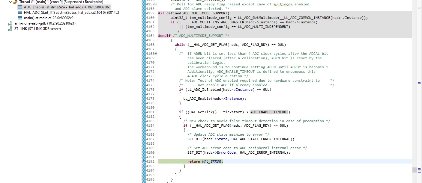

I have noticed that function ADC_Enable returns an error (HAL_ERROR) - timeout occours.
0693W00000LydFZQAZ.pngBut if I again call HAL_ADC_Start_IT it returns HAL_OK. I'm not sure what is happening here. Also interrupts are comming and HAL_ADC_GetValue is still returning value 0.

MApli.1AuthorBest answer
May 11, 2022 1:41 PM UTC
Below code needs to be added after inicialization of adc in order for adc to work:
 __HAL_RCC_PWR_CLK_ENABLE();
 HAL_PWREx_EnableVddA();
