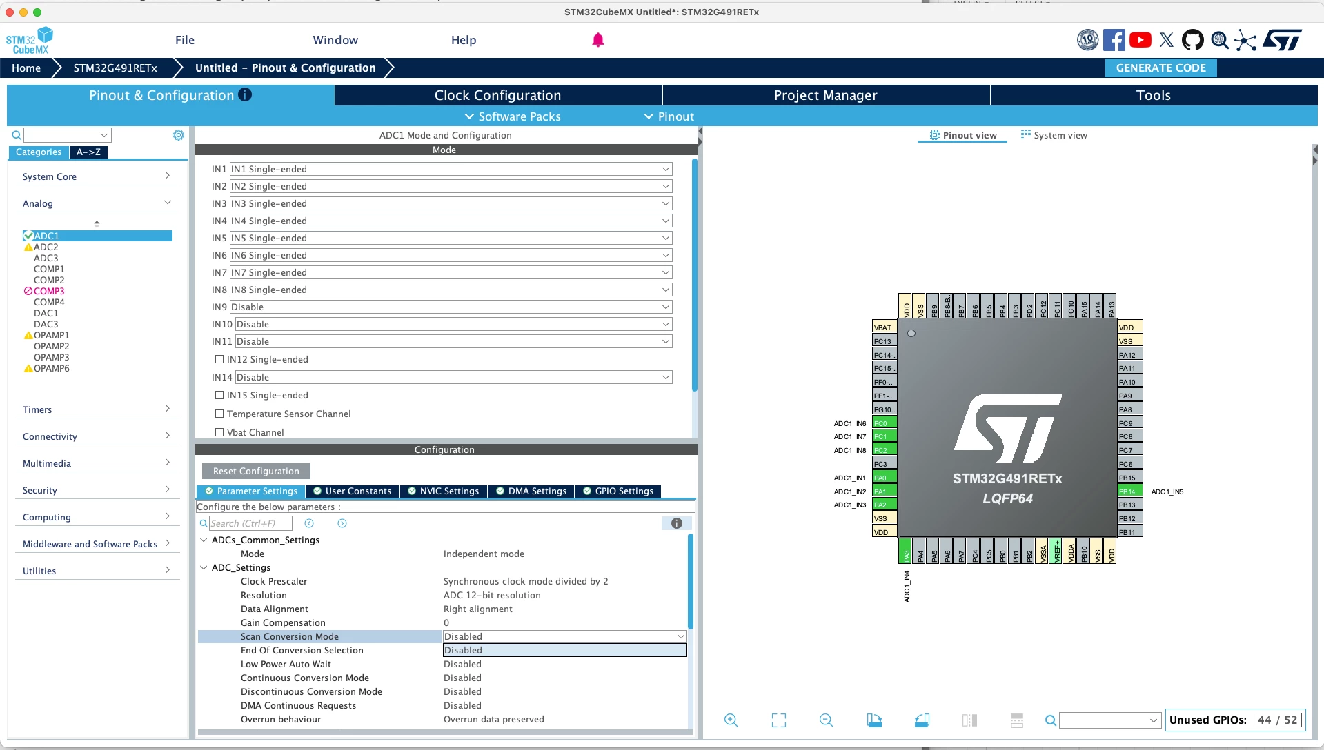

Setting up ADC Scan Mode using STM32CubeMX
I have created a new project based on the STM32G491 and have used ADC1 to create eight ADC inputs.
The only option I have presented for ADC Scan Mode is Disabled. What do I need to do to enable Scan Mode please?

Increase the “Number of Conversion” to 8 and then try.

Thanks ​@MGogr.1
Yes that worked. Maybe obvious in hinds=sight but not mentioned anywhere in the STM32 documentation.
