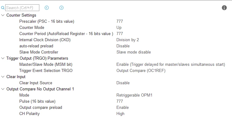

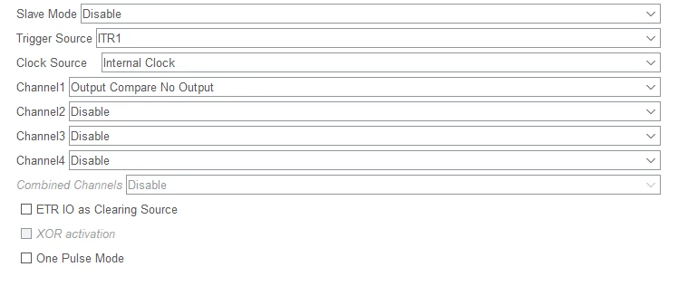

Using MX, I setup TIM3 as below.

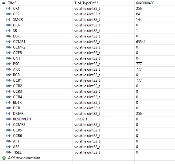

So, I'm expecting TIM3->CNT to have a different value each time I push the 'Resume' button.
But TIM3->CNT is always zero.

Here's what I put in the MX configuration for TIM3...
 I didn't edit the MX-generated code - just added breakpoint.
Here's TIM3 in the debugger expression window..

I found the problem: need to enable the timer.
This method works.
Count has a different value (almost) every time I press 'Resume'.
