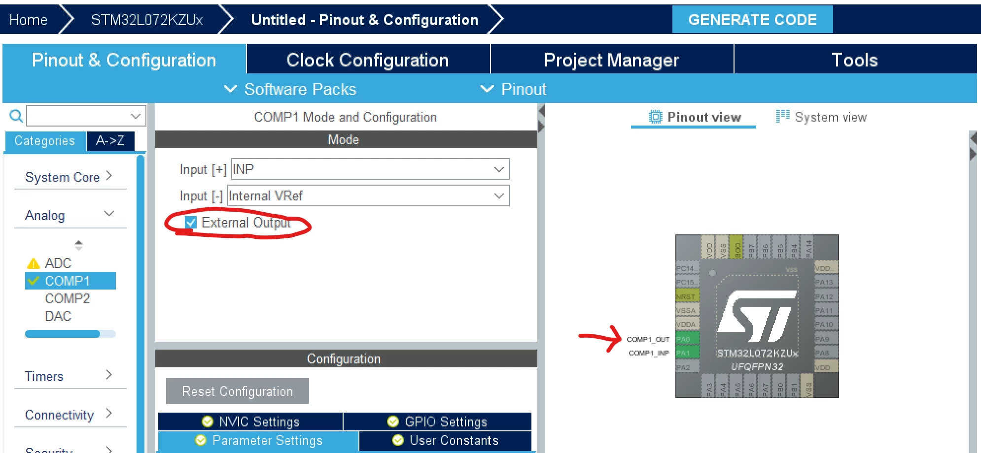

TDKBest answer
Sep 22, 2020 5:59 PM UTC
enable external output?

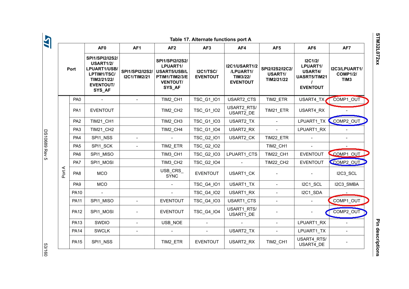

waclawek.jan
Sep 22, 2020 6:20 PM UTC
Set the respective pin to AF in GPIO_MODER, and select the proper AF number in GPIO_AFR.
