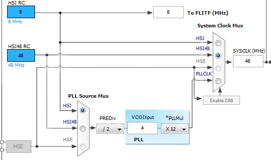

I'd like to migrate a project from using the internal RC on the STM32F091RC to the 8MHz HSE clock that comes down from the on-board ST-LINKV2's MCO signal.  I use STM32CubeMX to generate SystemClock_Config().  On the panel to the left in the Pinout window, I expand RCC and change 'High Speed Clock (HSE)' from 'Disable' to 'BYPASS Clock Source'.
When I do that, everything looks like it's good.  The PF0 pin goes green, the Clock Configuration screen lights up the 8MHz Input Frequency at HSE in blue.  If I generate a report, the RCC section says 'High Speed Clock (HSE): BYPASS Clock Source', but when I generate the code, I get the exact same SystemClock_Config(void) I got before the change.  In fact the freshly generated main.c doesn't change at all as result of the different clock selection in the gui.  Any ideas?

I check the Clock configuration tab for the two *ioc files and the same Clock settings is usedfor the two projects : HSI48 to
drive the system clock.
so it is expectedthat you have the same generatedSystem Clock Configuration for two test cases.
now to use the HSE bypass:
  1. Enable the HSE bypass in Pinout tab(already done)
  2. Then in the Clock configuration tab select HSE as source to drive system clock :
-Nesrine-

Doh!  I completely missed the clock configuration step.  Thanks Nesrine for the very speedy turnaround on this.  I'm now happily clocking on the 8MHz HSE clock.
