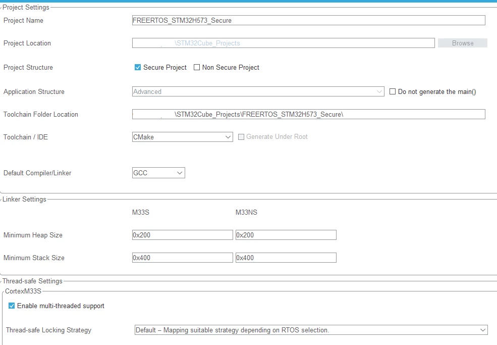

I have an issue with STM32CubeMX 6.17.0 (Windows 11 + Visual Studio Code)
I want to start a STiRoT Full secure project (with DA and encryption) for STM32H573 with FREERTOS.
But when I add the freertos software pack, I don't get any configuration options.
  • Open STM32CubeMX
  • Start My project from MCU
  • Select STM32H573IIK3Q (same as STM32H573I-DK)
  • Enable ICACHE and MPU -> Yes
  • With TrustZone

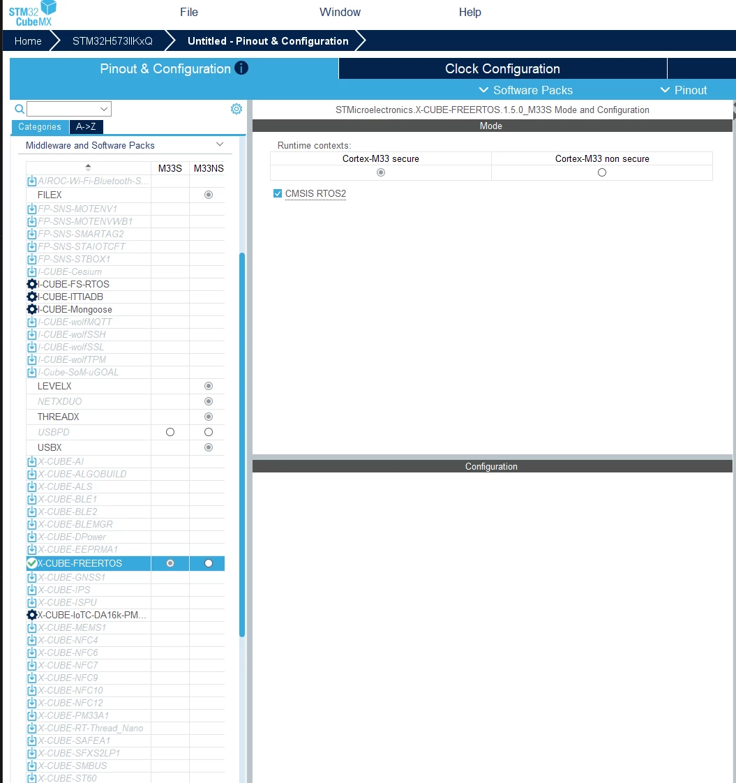

  • Software packs -> Select Component -> Cortex-M33 Secure -> X-CUBE-FREERTOS 1.5.0 -> CMSIS RTOS2 11.2.0 -> Core : TZ_Secure (I can't select Heap???)
  • No configuration is shown

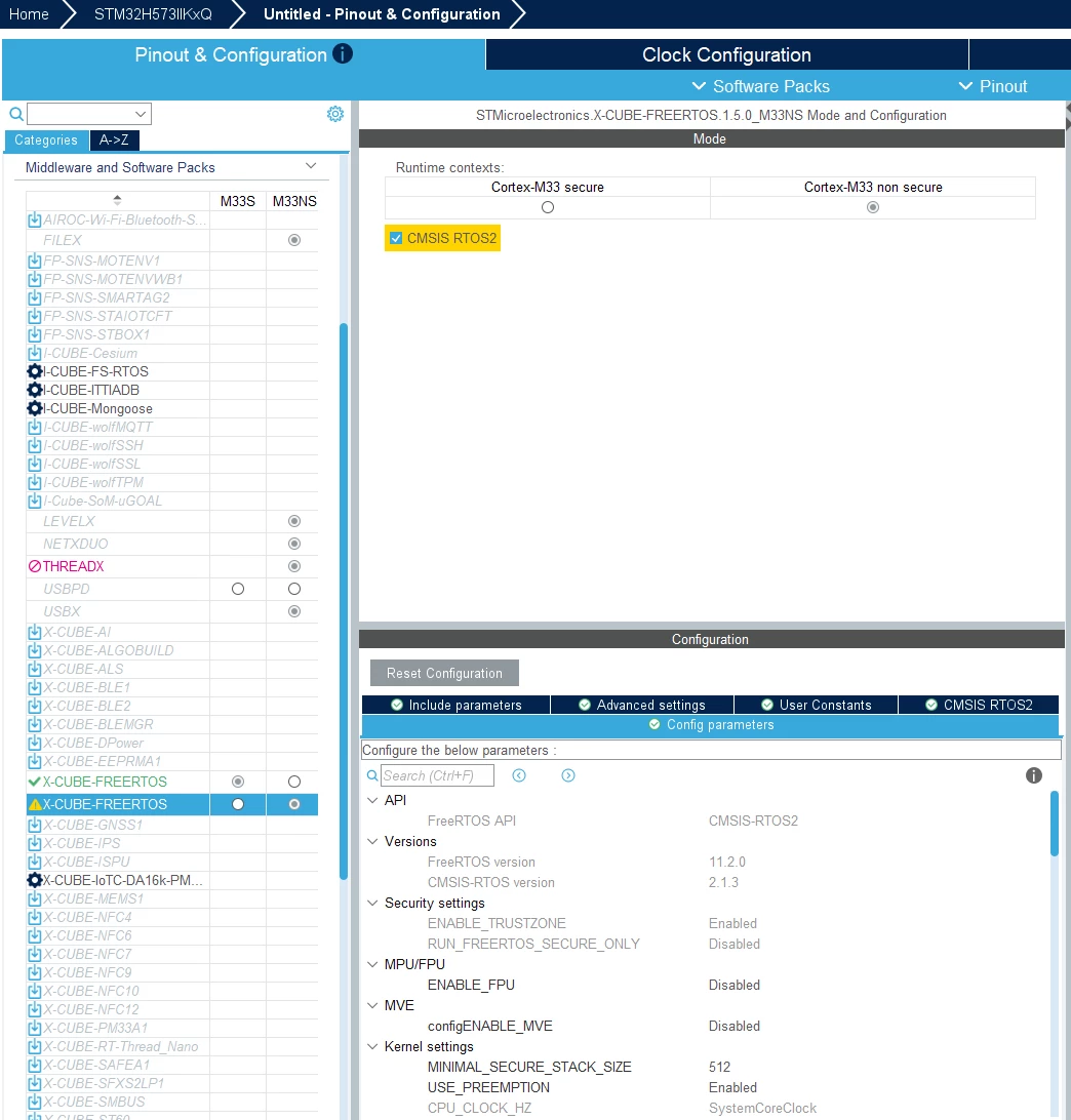

If I add FREERTOS to non-secure I am able to open configuration options

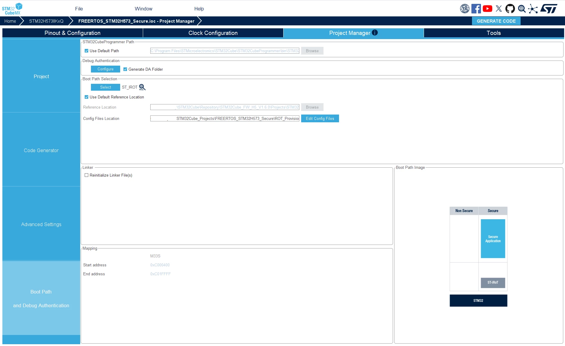

I'm planning on using the STM32H573 (or maybe the STM32H5F5) in a new product and I'm planning on using the full STiRoT, with secure encrypted updates but I want to use FREERTOS in the secure part.
One more question, hope that it's not too much offtopic, if so I will make a seperate post.
When selecting a secure-only project (without non secure).
With DA and STiRoT. Why does the mapping for M33S start at 0xC000400 and not on 0xC0000000? Does this mean that my "Firmware Execution area offset" and "Firmware download area offset" can't both be 0x00100000 (1MB) but should be a little bit smaller? Or does the tool take that start offset into account?

After several attempts, STM32CubeMX always worked correctly, and I was able to enable
X-CUBE-FREERTOS in both the secure and non-secure contexts. This suggests that the shared .ioc file may have been corrupted.
Regarding the missing FreeRTOS configuration options in the secure context, the key point is that STM32CubeMX is mainly designed for the simpler TrustZone use model.
In this model, FreeRTOS tasks are typically created in the non-secure world, while the secure world provides protected services such as:
1- access to secure peripherals,
2- secure function calls,
3- or other trusted operations.
In a multitask environment managed by FreeRTOS, non-secure tasks may need to request services from the secure world. These interactions must be synchronized properly so that secure processing does not interfere with the expected real-time behavior of the system.
So, from a tooling perspective, CubeMX mainly supports this standard architecture, which is why the usual FreeRTOS task configuration is available on the non-secure side.
It is still technically possible to run an RTOS and create tasks in the secure world on a Cortex-M33 with TrustZone, but CubeMX does not provide full support or configuration UI for that advanced use case. If secure-side tasks are required, they generally need to be implemented manually by the user.
