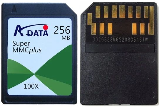

eMMC 8-Bit and DDR on both H7 and L4+ platforms, works quite well, 64 GB and 128 GB, good for automotive temps and high vibration environments.
MMCPlus (MMC+) cards had an 8-bit flavour, have a couple, but the sockets are impossible to find now.
