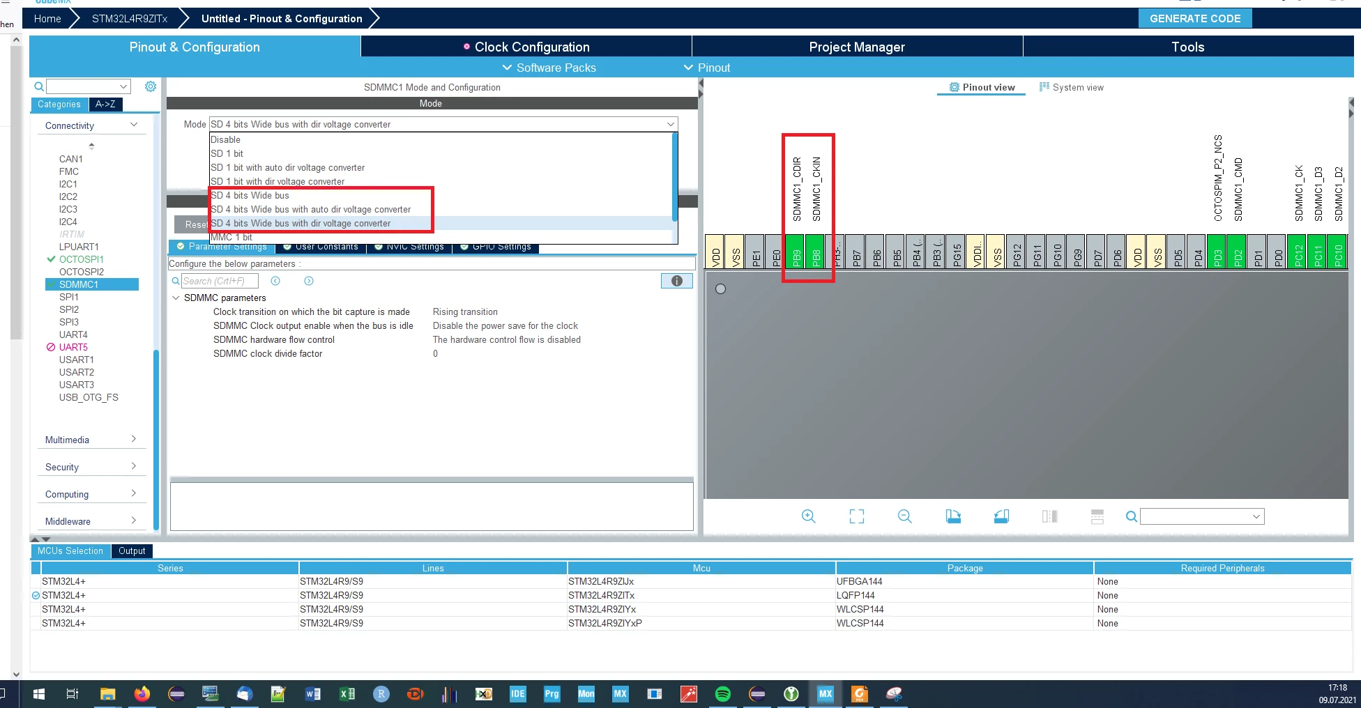

Hello Community,
I use the STM32L4R9ZITx and would like to save data on a MicroSD card via SDMMC1. Usually I use the SD 4 bit wide bus mode. After an update of CubeMX and the HAL layers now two more options are offered. One is "Auto Dir Voltage Converter", which occupies another pin (SDMMC1_CDIR) and the other is "Dir Voltage Converter", which selects an other pin (CKIN) in addition to CDIR. Since the identifiers are unknown to me and until now the pure 4 bit mode worked, I wanted to know what these two options are used for? Googling the identifiers was not very informative. I look forward to more information.

I'd imagine the reference manual has pictures, the H7 where these transceivers were first used did. Look at the H7 docs if the L4+ ones aren't illustrative.
The transceivers were use where the card voltages are dropped to support high data rates, clocks and DDR modes.
The CKIN provides a full-loop feedback to understand how the clock/data has been skewed end-to-end, allowing for correct recovery of data placed on those edges.
The direction pin controlling the buffers and it transitions through phases of the data/command transfers with the cards.
If you're driving your cards at 2.9V - 3.3V, probably should just stick to the D0..D3, CLK, CMD wiring, and SDR data clocking. Should be able to hit 50 MHz with minimal design effort.
