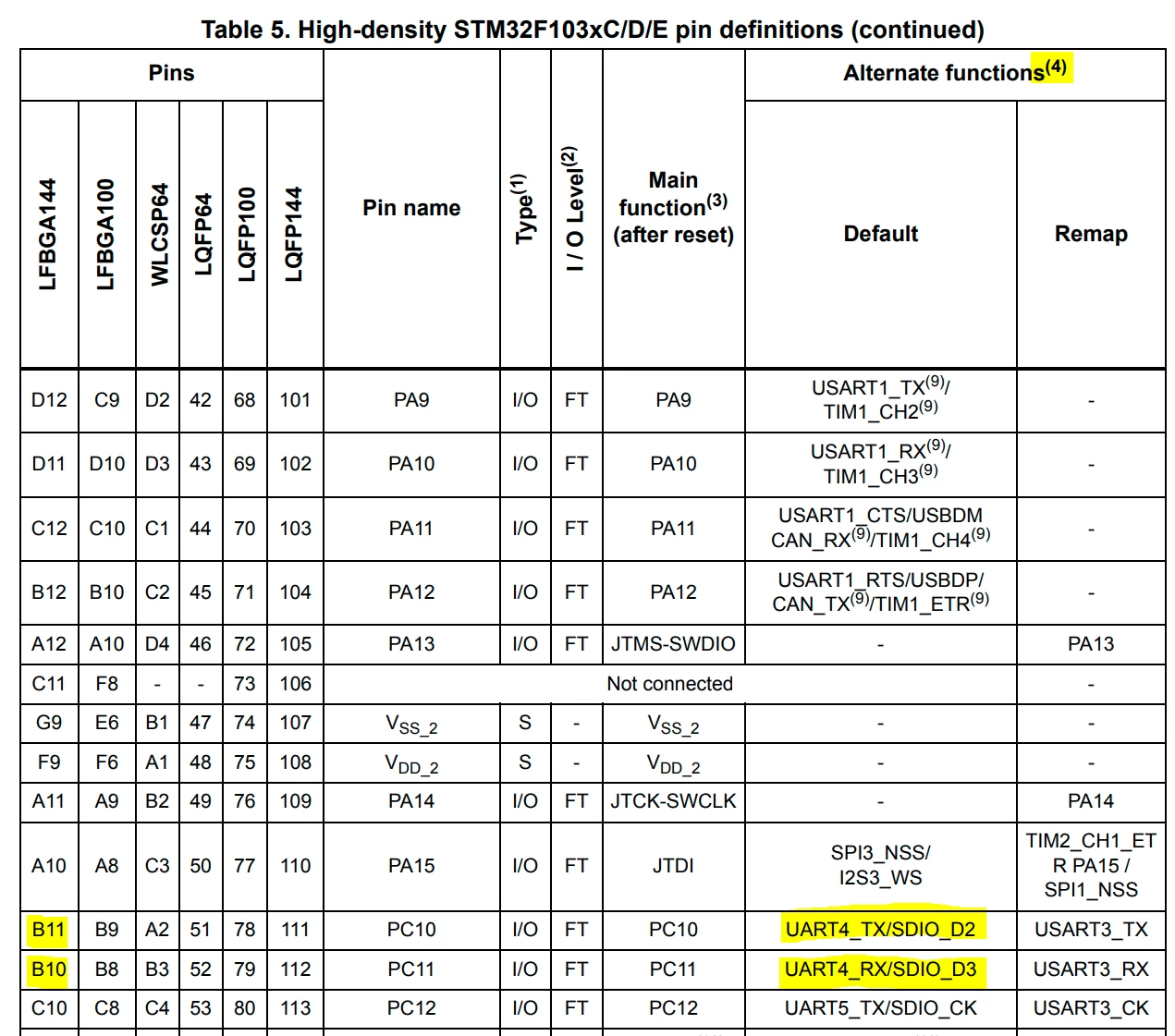

I want to use uart4_tx and sdio at the same time.
But, in cubemx(6.2.1),
SDIO->Mode: SD 1 bit
UART4->Mode: only Disable.

If pins are shared between peripherals, and there are no alternatives, you cannot use them at the same time. Larger chips typically have more options.

Could you please share your .ioc file to check from our side or at least precise which MCU are you using ?

MCU:STM32F103RCT6 LQFP64.
Attachment is the ico file.

The STM32F1 family assigns pins on a per-peripheral basis rather than per-pin. Less ancient families do this on a per pin basis. So even though you aren't using SDIO_D2, it shares its functionality with UART4 and you can only have one enabled per the datasheet.

Now the problem is, even if I use the "HAL_SD_DeInit" function to turn off the SDIO clock, and then execute the uart4 initialization function, but uart4_ TX is still unable to send data.
		ret = HAL_SD_DeInit(&hsd);
//		RCC->AHBENR &= ~(1<<10);
//		SDIO->DCTRL &= ~(3<<10);
		osDelay(1000);
		uart4_init(36,250000);
		osDelay(1000);
		while((UART4->SR&0x40)==0);
		UART4->DR = 0x5A;
May 26, 2021
Is the pin initialized in the correct AF mode? Show the relevant registers.
