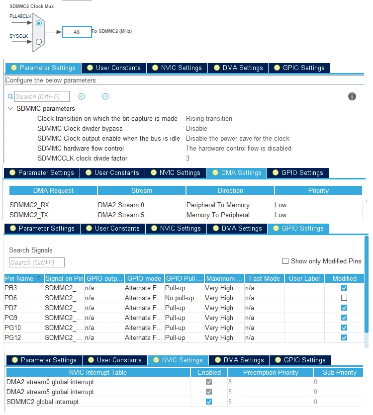

I am having a problem with SDIO (SDMMC2) interface on STM32F769i Discovery. I use the DMA-based SDIO, CubeMX (v5.6.1) to generate the codes. Also freeRTOS enabled.
After I called "BSP_SD_WriteBlocks_DMA(aTxBuffer, BLOCK_START_ADDR, NUM_OF_BLOCKS);", at some point, the HAL_SD_IRQHandler is triggered. and inside this handler, I got an error: HAL_SD_ERROR_DATA_CRC_FAIL. Then HAL_SD_ErrorCallback is triggered, instead of the HAL_SD_TxCpltCallback.
Any clue what is the cause of this CRC error? My settings are following:

I found the reason. The CubeMX assigned a PIN for sdmmc2-D3, which is not the PIN connected to D3 in the discovery board. After fixing this, everything works.
