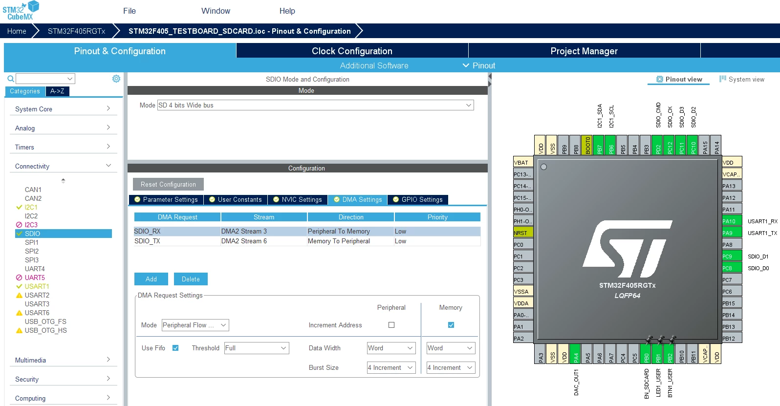

Q1: How to check if DMA is working?
Where can I see/check that I actually use the DMA which is added in CubeMX in the SDIO section?
Because if I remove the two DMA lines for RX and TX and press the "GENERATE CODE" button again, after re-compiling my unchanged user-code is still working perfectly. I thought there should be a problem now...

Q2: How to check if 4Bit Mode is set correctly?
After generating the library functions with CubeMX I found the first hint in the MX_SDIO_SD_Init() function:
hsd.Init.BusWide = SDIO_BUS_WIDE_1B;
I think this sets the bus to 1B for the very first initialize/communication?
After calling the BSP_SD_Init() to initialize my SDCard I see in the library-code that a wide operation is enabled.
   /* Enable wide operation */
   if (HAL_SD_ConfigWideBusOperation(&hsd, SDIO_BUS_WIDE_4B) != HAL_OK)
     sd_state = MSD_ERROR;
Is this the final step to set the 4Bit SDIO data transfer or do I need something else?

To whom it may concern:
regarding Q2:
Thanks to an oscillocope I can tell you "yes". BSP_SD_Init() sets the BUS to 4 wire mode which can be seen on the osci creen (if you read or write data of course). If you manipulate the BSP_SD_Init() and set it to SDIO_BUS_WIDE_1B instead of SDIO_BUS_WIDE_4B, data communication is only available on the SDIO_D0 pin.

Tesla DeLorean
Guru
April 2, 2020
Drill into the DISKIO layer, and see what functions it is calling, the DMA ones, or not.
Check if you have interrupt handlers in stm32f4xx_it.c, etc.
Look at a .MAP file to see what functions are linked/bound rather than discarded.
