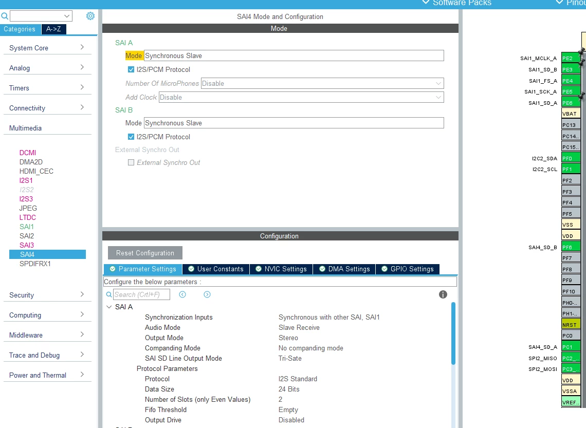

Hello All, I am trying to get Full Duplex I2S working with a STM32H7 and a PCM3168A.

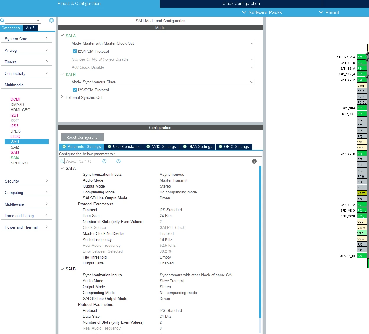

The STM has 2 SAI blocks (SAI1 A/B) (A in master mode and B in synchronous slave) for sending data to the PCM for the DAC part of the PCM. I use this to transmit 4 Mono signals. This works with double-buffered circular DMA.
I then have 2 SAI block (SAI4 A/B) both configured as synchronous slaves. both synchronized to SAI1. These should receive data from the ADC portion of the PCM. I want to setup a circular DMA transfer for this as well, to take data from the PCM and transfer continuously to a buffer.
I can start a DMA transfer with
status = HAL_SAI_Receive_DMA(&hsai_BlockA4, (uint8_t*)&adc0DMA, ADCDMABUFFERSIZE);
And status returns HAL_OK. But I only ever see 0's in the adc0DMA buffer. I can see I2S data on the incoming SD data line. I also have global interrupts enabled for the SAI, but the following generated handlers are never called when I set a breakpoint:

Am I missing an initial setup step that is not auto-generated? From what I understand SAI4 should be in sync to SAI1 with the frame signal. I know SAI1 is working and is generating signal on the PCM.
Connections:
Master-Clock, Bit-Clock, and Frame-Signal come from SAI1 and attach to the PCM (Both ADC and DAC sections as both are in "slave" mode on the PCM device).
SAI1_SD_A and SAI1_SD_B come from SAI1 and attach to the PCM.
SAI4_SD_A and SAI4_SD_B come from the PCM and attach to SAI4.
SAI1:

I found out my issue - I had not enabled "External Synchro Out" in the .ioc configuration on the master , (SAI1). After enabling that the slaves began to work.
I also ended up switching from SAI4 to SAI2 for the slave. Because only the BDMA was attached to SAI4 and that uses memory region D3.
