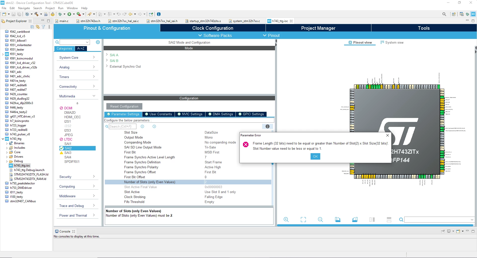

SAI slot number bug in CubeMX 6.4.0
Datasheet claims that with FSDEF=0 (FS signal is start frame, not channel identificaion) i can set up number of slots (NSBLOT) to any value. In my case 1. CubeMX claims that it must be equal two (which is not true). When i try to set value to 1, then CubeMX show error with info that value need to be less or equal 1... and then forces value to 2 :D ... demonstrated on printscreen.
I can change number of slots to 1 in source code and SAI works well. But... you know what happen when i regenerate code ;)

Hello @Michal Dudka​ ,
Thanks for your feedback,
Actually, The number of slots must be equal to 2 in your case because the Output mode is set to MONO. If you set the Output mode to stereo, you will be able to set the number of slots to 1 .
For more details please check the RM0433 page 2284.

The reference manual:
Bit 12 MONO: Mono mode
This bit is set and cleared by software. It is meaningful only when the number of slots is equal to 2. ...
