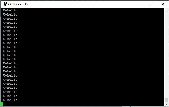

I got an interesting bug when working with the queue (STM32CubeMX 5.6.1 + lib 1.25 in STM32F407VGT6):
typedef struct
uint8_t* data;
uint16_t len;
} message_t;
uint8_t str[] = "hello\n";
for(;;)
message_t* message;
if ((message = osMailAlloc(ComOutputQueue, 0)) == NULL)
// no action
else
message->len = 6;
message->data = malloc(6);
if (message->data == NULL)
osMailFree(ComOutputQueue, message);
for (uint16_t i = 0; i < 6; i++)
message->data[i] = str[i];
osMailPut(ComOutputQueue, message);
CDC_Transmit_FS((uint8_t*)str, 6);
osDelay(30);
CDC_Transmit_FS(message->data, message->len);
osDelay(30);
The ComOutputQueue is declared and initialized.
What am I doing wrong?
Best answer by Pavel A.
Note use of malloc in a thread.
Mr. Nadler to the rescue?
-- pa

Pavel A.
Pavel A.Best answer
August 10, 2020
-- pa
