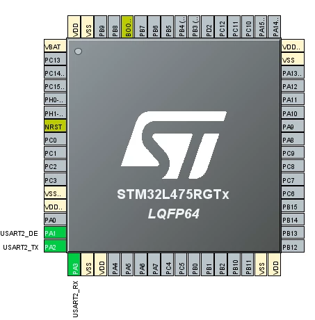

I have a device whith USART2 (PA2 and PA3) connected to a RS485 transceivers and i would like use the PA1 pin as DE, as below:
This works correctly and the DE PIN is toggoled correctly.

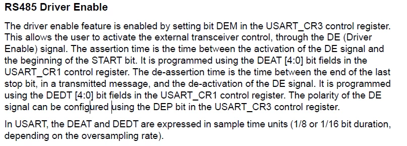

From the reference manual, I have seen that I can set the DEAT and DEAD fileds in the USART_CR1 register which should raise/lower DE with a certain advance/delay.

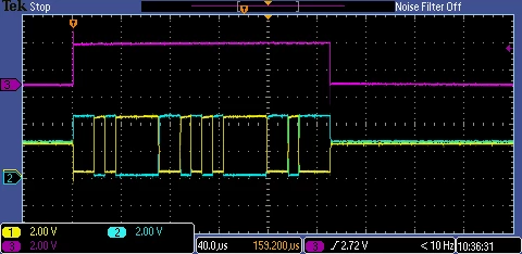

0693W00000Y7wvUQAR.pngAlthough I set these registers to the maximum value however I don't see any difference on the oscilloscope, I am attaching a screen:
0693W00000Y7ww8QAB.pngDo you have any idea what could be the reason? I am also attaching the project files.

waclawek.jan
Jan 11, 2023 1:05 PM UTC
Read out and check/post UART registers' content.
