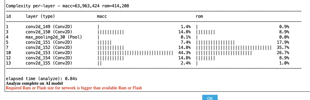

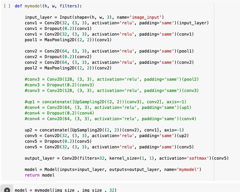

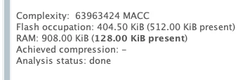

Hi, I'm trying to load my Keras model (built for CamVid dataset) into STM tool, but when I try to analyze even with compression set to 8 it gives me the "Required Ram or flash size for network is bigger than available Ram or Flash" alert.
I tried to modify my model also trying to eliminate various layers, but nothing.
the model is:
0693W000006EkSrQAK.pngand this is what I have after the analyze:
0693W000006EkT1QAK.png0693W000006EkT6QAK.pngany idea? thank you!!

Dear @LForm.1​ ,
The RAM size in STM32f441 is only 128kbytes and your project need more size of RAM.
It's recommended to use another STM32 microcontroller with larger RAM memory.
