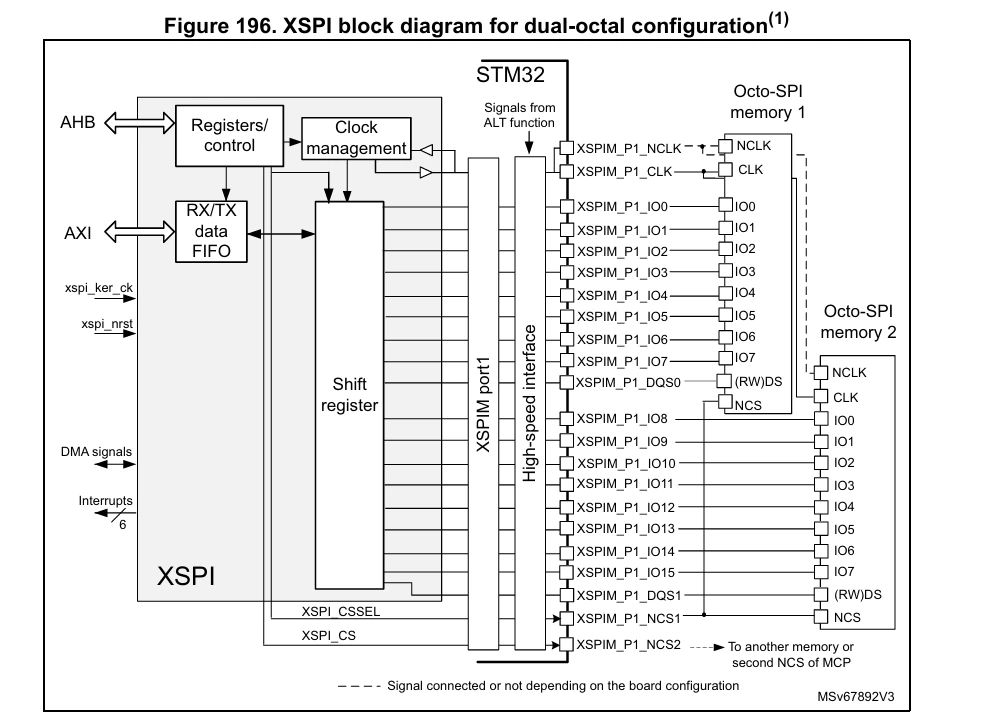

We are working with the STM32N657X0H3Q microcontroller in our custom hardware design. We have interfaced S80KS5123GABHB020 Octal RAM devices with the controller using the XSPI interface.
In our design, we are using a dual Octal memory configuration as described in the STM32N6 Reference Manual. The two 8-bit memories are configured to operate together as a 16-bit external memory interface.
We would like your guidance regarding the correct STM32CubeMX configuration settings for this dual Octal memory setup.

  • Interface: XSPI
  • Memory Configuration: Dual Octal mode (two 8-bit memories forming a 16-bit interface)
  • Intended usage: External RAM for (ltdc)framebuffer
  • Memory mapped access: XSPI memory-mapped mode
Could you please confirm the recommended STM32CubeMX settings for the following parameters?

Hello ​@Shivani and welcome to the community;
There are differences between dual-octal mode and hexa mode. For example in Dual octal mode two external octal-SPI devices (device A and device B) are used and  in XSPI  (hexa)  mode a single external XSPI device is used.
For that, I recommend you to look at RM0486 precisely sections  Dual-octal configuration and  XSPI mode.
I advise you to look at How to execute code from the external PSRAM using the STM32N6 | Community article may help you.
For  missing Dual octal mode in STM32CubeMx, I reported this issue internally for checking and fixing.
Internal ticket number CDM0065082 (This is an internal tracking number and is not accessible or usable by customers).

Dear Kaouthar,
I have downloaded and installed the latest version of STM32CubeMX, but I still do not see the Dual-Octal mode option.
Could you please check the status of internal ticket CDM0065082 and let me know when the Dual-Octal mode support will be available in STM32CubeMX?
