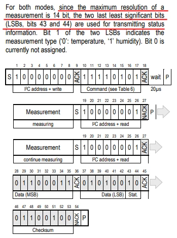

I tried to communicate using I2C, but I failed...
So, I would like to get help from those who are good at I2C communication.
The board uses NUCLEO-L073RZ, and the device to communicate with is "SHT20 (Humidity_Sensors)" of Sensirion company.
I tried to communicate using I2C function in STM CUBE MX, but the sensor seems to communicate with 13bit... MX only supports 10bit....Please help....

Andrew Neil
Jul 7, 2022 10:04 AM UTC
"the sensor seems to communicate with 13bit... MX only supports 10bit...."
What do you mean by that?
According to the SHT20 datasheet, it uses standard 8-bit data size:

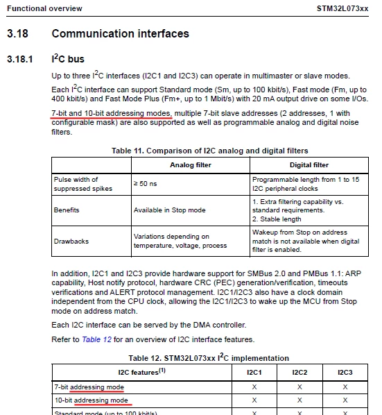

Andrew Neil
Jul 7, 2022 10:27 AM UTC
@Damdori​ "MX only supports 10bit...."
Are you confusing data size with the addressing modes there?
Damdori
DamdoriAuthor
Jul 8, 2022 6:29 AM UTC
Ah, I guess I misunderstood.
In fact, I don't know much about i2c communication, so I first download the example source from SENSIRION and write the program.
The example source seems to have been written as a code that measures while directly changing the registry that defines the input and output for I2C SDA and SCL pins, but it is too difficult to directly touch the registry in the HAL function...
KnarfB
Jul 7, 2022 10:06 AM UTC
why do you think so? According to the data sheet, the sensor has a 7-bit I2C target address and normal, byte wise data transfer.
hth
