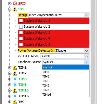

@Uwe Bonnes​ it seems that it is not possible to use LPTIM as system timebase source:
Also, it seems that the only sources I can use for LPTIM clocking are not precise ones...

I don't even know that ST sets that constant. Any way ARM suggests providing a default value, but you get to program whatever you want for the period, so the frequency of the CPU and if the ticker fires at 1 KHz or something else is entirely up to you.
The point with the LPTIM is you could use it or the RTC to provide the HAL timebase​, you're not tied to SysTick. Even RTOS should be workable with a different periodic IRQ.
