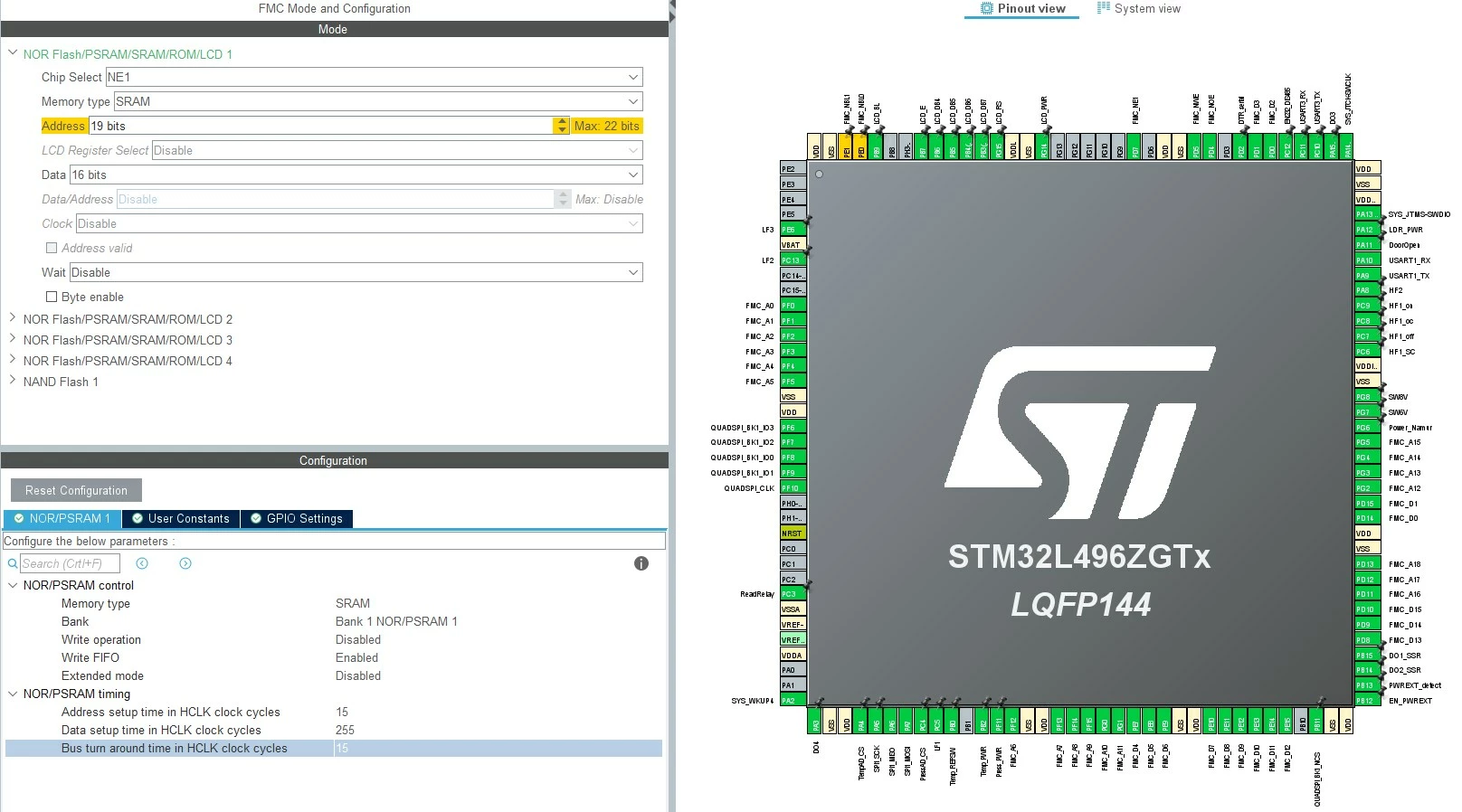

I am using stm32l496, I want to use external memory CY62157EV30L, so I enable FMC in the CubeMx, but when I compile and run the project, a lot of current is consumed, about 4 mA, only with MX_FMC_Init(). how can I reduce this current?
HCLK is 2 MHz.
I attached FMC setting.
Thanks.

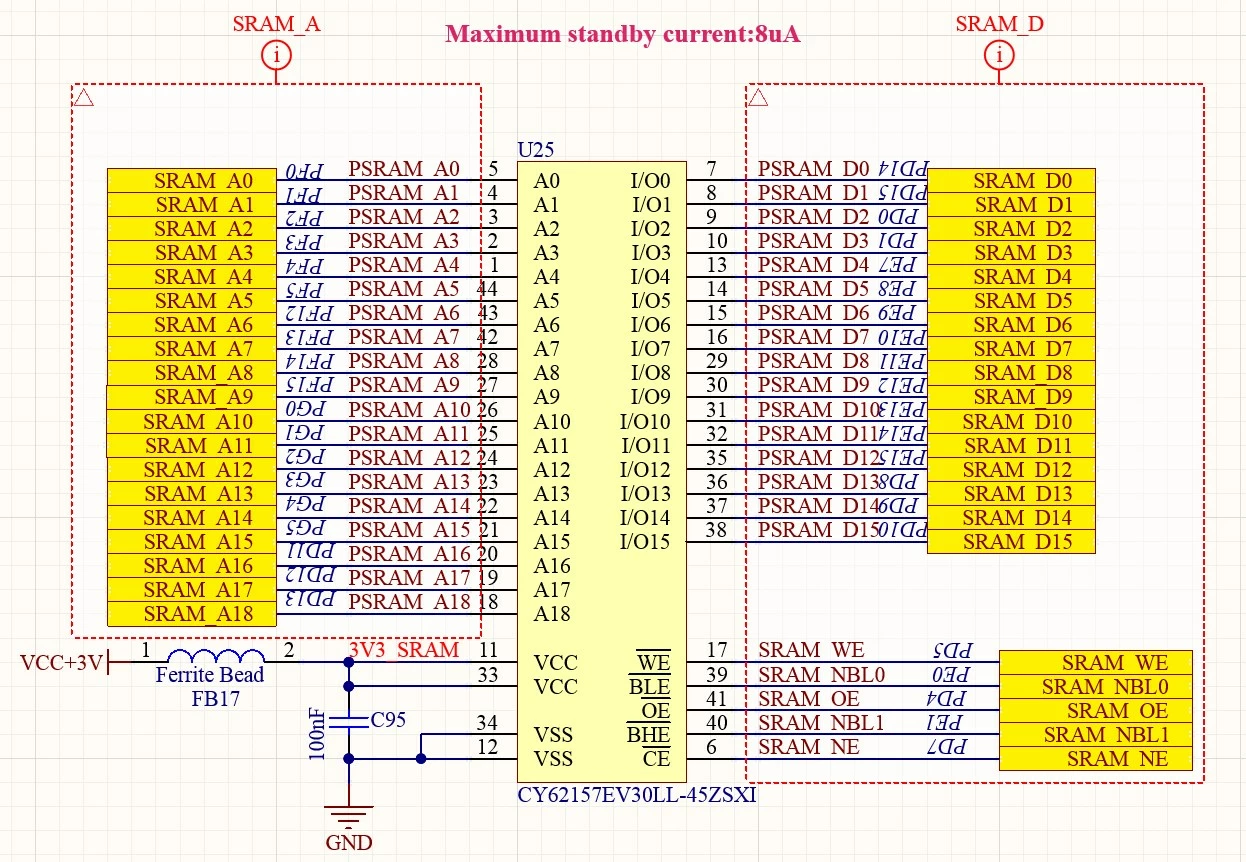

alianvari
alianvariAuthor
Nov 9, 2021 12:12 PM UTC
Thank you for your help.
I connected the memory pins directly to the micro.
I have attached a schematic photo of the memory.
waclawek.jan
Nov 9, 2021 12:16 PM UTC
How are nCE1, CE2 and nWE, nOE, nBHE, nBLE of the memory connected to STM32? Did you measure signals on these pins using oscilloscope?
Is there any activity with the memory while measuring the current? Does the consumption include memory consumption? The memory has non-negligible consumption in mA range when active, see "Truth table" in the memory's datasheet.

waclawek.jan
Nov 10, 2021 6:11 AM UTC
Connection as designed appears to be OK based on the piece of schematic you provided.
> In the "Truth table" of memory, it is stated that in order for the memory to be in standby mode,
> pin nCE1 must be in the High state or pin CE2 must be in the Low state or nBHE and nBLE in High state.
CE2 appears to be present only on the BGA version of the memory, you probably don't use that, do you.
Check the levels on the control pins, using oscilloscope/logic analyzer. Also make sure in program that nothing accesses the memory during current/signals measurement.
You may perhaps want to write a test program, which sets up FMC but then sets all control pins as GPIO output and to their idle state (high).
You have a ferrite bead in series of the memory power supply, so you can measure its current consumption - do that, so you know where those 4mA go, into mcu or into memory or elsewhere.
Also, check if all control connections are OK (no bad solder joints, no shorts).
