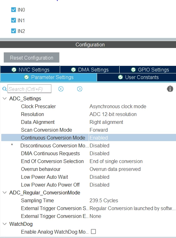

0693W00000BbcoMQAR.pngHi,
I'm trying to read ADC value from multiple ADC channels but reading the same ADC value for all channels.
This is my code snippet. Please support to fix it asap.

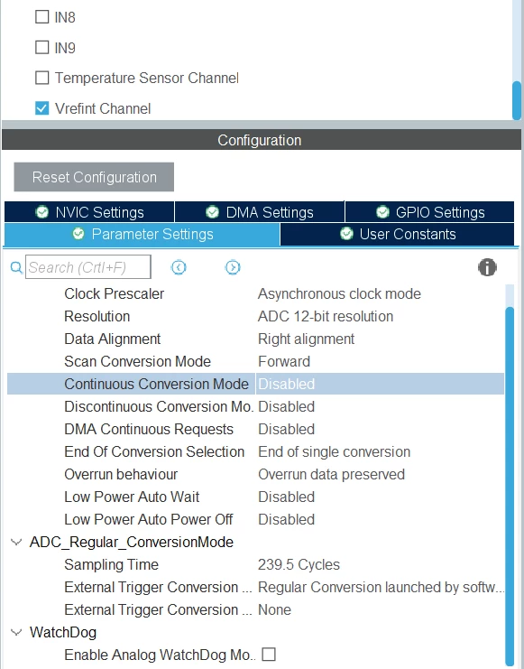

I believe I am having the same problem. My board is a Nucleo-L031K6 and I am connecting 2 analog inputs. If I sample only one (either one) the ADC count is correct. When I try to sample both inputs the counts are not correct. I tried very similar code on a Nucleo-F401RE and it works. On the F401RE IOC configuration tool the analog setup has more options (number of conversions, rank, etc). These options do not appear for the L031K6 board. Any help is greatly valued. I have fought this for 2 days. My code that does not work for the L031K6 is attached:

From your code samples, I see you do not use the same STM32 MCU, but your issue is similar.
Note for Doug: STM32L0 and STM32F4 ADC have not the same features: on STM32L0, channel rank in the sequence cannot be configured, it is fixed to channel number.
The issue is due to overwritten data: when a sequence of several ADC channels is configured, in default configuration, a ADC start event makes ADC converts all channels successively in burst. Therefore, data register is overwritten by each new conversion data. If you do not fetch each conversion data on time, you get the only last one.
I propose 3 solutions to your problem:
1. Use discontinuous mode
In this mode, ADC does not convert all channels in burst but requires a ADC start event for each channel.
Setting: "hadc1.Init.DiscontinuousConvMode = ENABLE;"
Sequence principle:
HAL_ADC_Start(hadc1);
HAL_ADC_PollForConversion(&hadc1, <timeout>);
data_conversion_1 = HAL_ADC_GetValue(&hadc1);
data_conversion_2 = HAL_ADC_GetValue(&hadc1);
HAL_ADC_Stop(hadc1);
2. Poll for each conversion (not recommneded)
Not recommended, because of your CPU is busy at another task, then you will miss some conversion data.
Sequence principle:
<do not process anything else here !!!>
3. Use DMA transfer (recommended)
ADC converts all channels successively in burst and DMA transfers data in RAM (no CPU intervention).
Then user program can access all conversion data in a table: [data_conversion_1; data_conversion_2]
You can refer to examples in FW packages.
