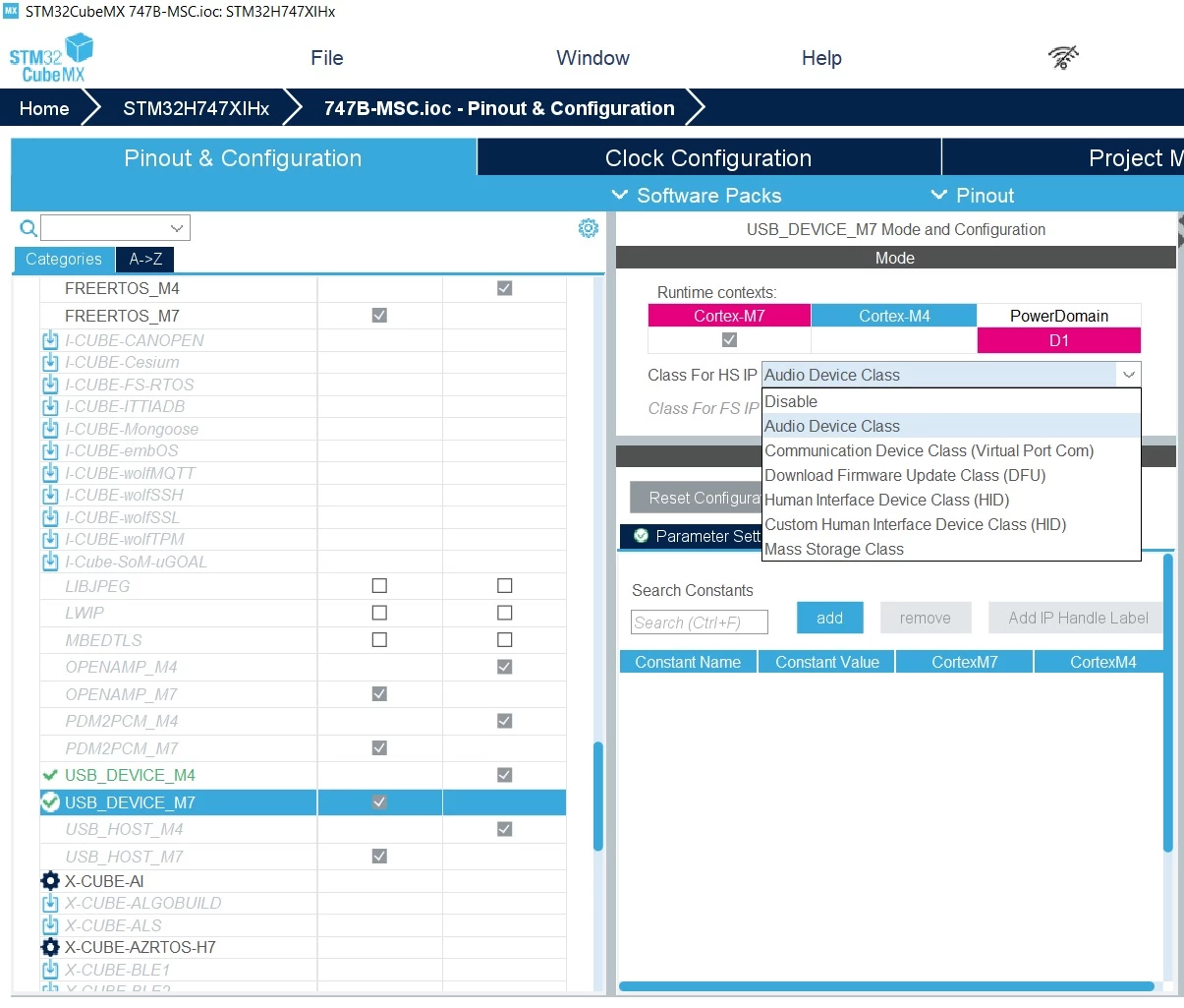

Another question are no UVC can select in the CubeMX USB class.USB No UVC.jpg

    Hi @Antonic_Future
    Unfortunately, Video Class is not supported on STM32H7 product. Your query has been submitted to dedicated team.
    Internal ticket 198286 has been created to track the addition of this USB class to CubeMX on H7.
    To give better visibility on the answered topics, please click on "Best answer" on the reply which solved your issue or answered your question.Best regards,FBL
