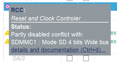

RCC config problem
Latest CubeMX.
Steps to reproduce RCC config error
1. Board:STM32H747I-DISCO
2. Click on X-CUBE-AI, select Cortex-CM7, select Install for X-CUBE-AI/Core, press OK
3. Project manager: set project name, toolchain: CubeIDE, generate the code
4. Click again X-CUBE-AI: suggests to fix clock issues, press Yes
5. Go back Pinout & configuration: RCC reports error. Also how to fix it? (see the picture)

Aug 8, 2023 1:20 PM UTC
Hover over the red X next to RCC. What does it say is the issue? Perhaps try changing the voltage scale. The autosolver will not adjust voltage scale as it depends on input voltage.
Wasn't able to reproduce using a slightly older CubeMX.
