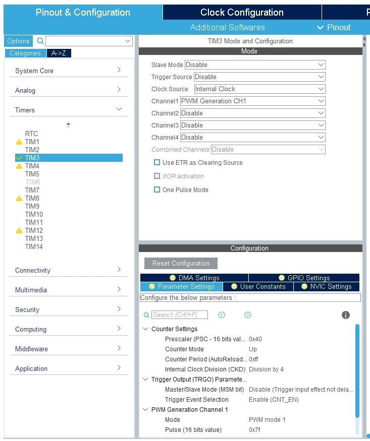

I've my LCD backlight control on STM32F429 pin PB4, and as a digital output it was fine. I chose this pin because it can be configured as a PWM output.
I've set up TIM3 Ch1 in CubeMX. I just want a free-running PWM with a dynamically configurable duty cycle, so I can set my backlight to 'bright', 'medium' or 'dim' settings.
I'm getting no signal on PB4, it is just sitting high.
Did I miss something? Is there an 'enable' or 'start' instruction I need to add?

Alexmouse
AlexmouseAuthor
May 28, 2019 6:25 PM UTC
The pin is set to the alternate function, timer output. I'd assumed CubeMX would set things up ready to roll.
I've driven the backlight from a sig generator so have a good idea of requirements.​

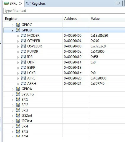

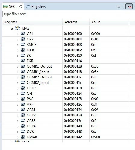

waclawek.jan
May 28, 2019 7:05 PM UTC
Read out and check/post content of timer and relevant GPIO registers.
Alexmouse
AlexmouseAuthor
May 29, 2019 7:40 AM UTC
Alexmouse
AlexmouseAuthor
Alexmouse
AlexmouseAuthor
May 29, 2019 7:41 AM UTC
If this were a PIC micro, I'd go through the registers bit by bit, but here there are too many and descriptions are cryptic. In any case, isn't that why I'm using CubeMX?
Alexmouse
AlexmouseAuthor
May 29, 2019 8:11 AM UTC
OK, I've manually the TIM3_CR1 "CEN" bit, and now I can see the CNT register incrementing between breakpoiints. Still no activity on the PB4 pin assigned to TIM3 Ch1.

Alexmouse
AlexmouseAuthorBest answer
May 29, 2019 9:18 AM UTC
OK, I now have PWM on PB4, thanks to Uncle Google and this page
https://electronics.stackexchange.com/questions/179546/getting-pwm-to-work-on-stm32f4-using-sts-hal-libraries
I needed to add
 HAL_TIM_Base_Start(&htim3);
 HAL_TIM_PWM_Start(&htim3,TIM_CHANNEL_1);
Microchip's Code Configurator tool gives you a header listing all the functions to initialise, start, stop and control your configured peripheral, why can't CubeMX be as helpful?
