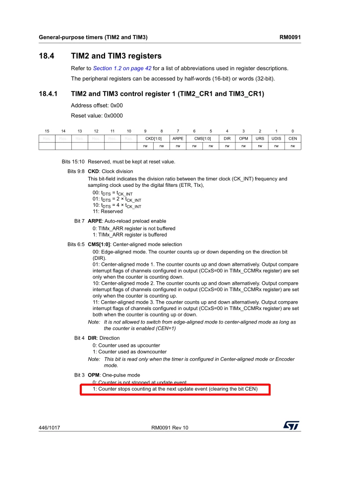

Hello, I'm using STM32F030C8 and I have created 4 PWM waveforms.
I want to create PWM and stop it after one cycle.
I'm thinking of how to create PWM and stop directly after one cycle.
Is there any other way?
Thank you.

August 6, 2024
htim5.Instance->CR1 |= (1 << 3);
HAL_TIM_PWM_Start(&htim5, TIM_CHANNEL_1);
I wrote the code like this, but it doesn't work. -> The signal will remain at the High level only.
Do you happen to have an example code?

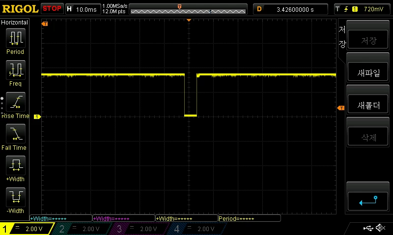

I'm changing pwm mode and opm mode using external buttons.
When entering opm mode, keep high level and generate pulse. I want to keep low level and generate pulse.

waclawek.jan
August 6, 2024
Then you have either use the other PWM mode, or invert the output signal using TIMx_CCER.CCxP.
You may need to change also TIMx_ARR and TIMx_CCRx between the PWM and one-pulse mode to fit your expected output waveform.
