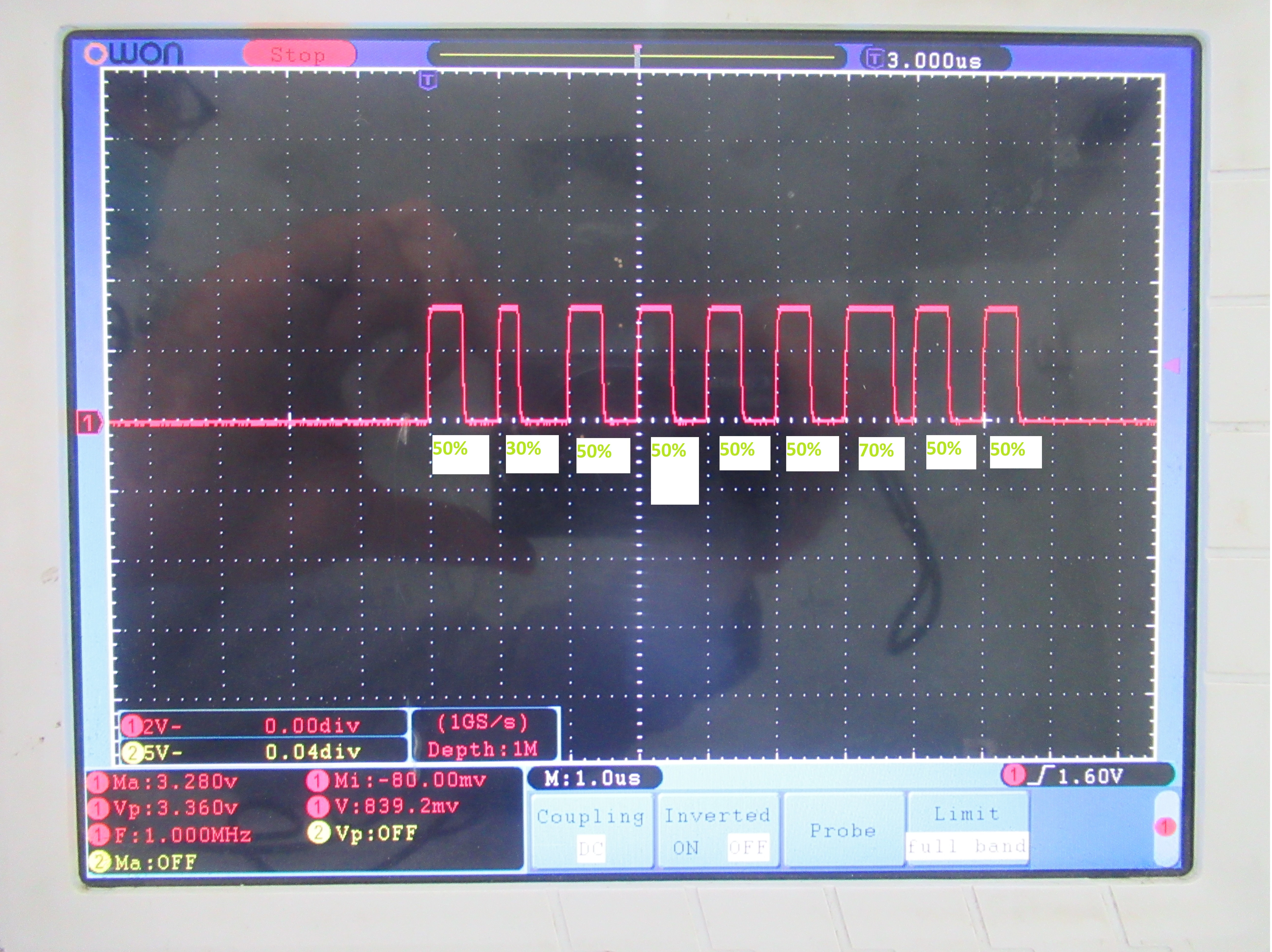

Hi everyone,
I meet some issue about PWM + DMA on STM32F103 (Bluebill KIT).
I generate 7 pulses with frequency 1Mhz and duty cycle of pulses is 50,30,50,50,70,50,0% sequence.
But the result have some issue:
  1. On my OSC, i see 9 pulses and it more than i need.
  2. The 50% pulses repeat 4 times before and after the 70% pulse.
I don't understand why !
>>> Signal on my OSC:
>>> Here is my config in CubeMX:

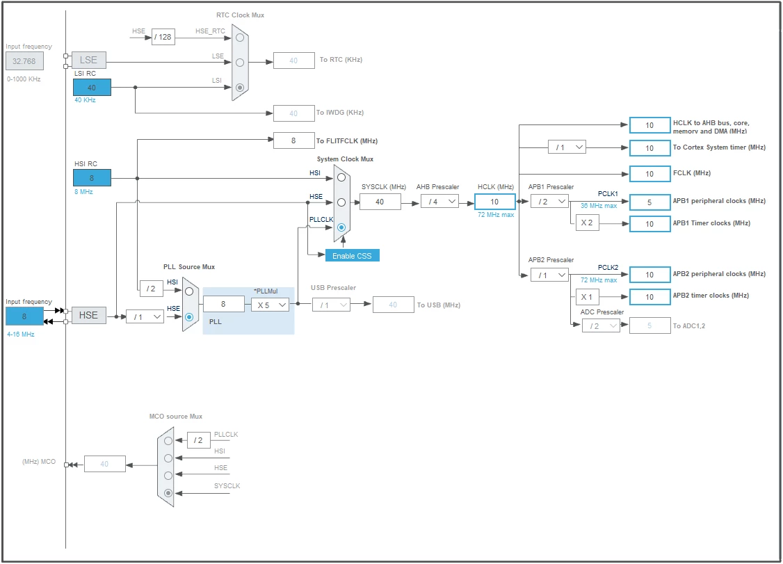

0693W00000FCxW5QAL.pngSys clock=40Mhz, Timers clock=10Mhz

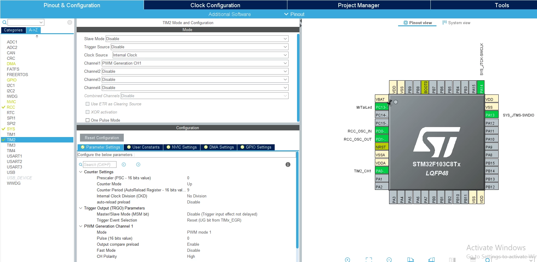

0693W00000FCxY1QAL.pngPWM config

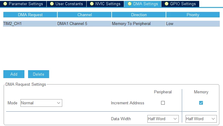

0693W00000FCxZsQAL.pngDMA config

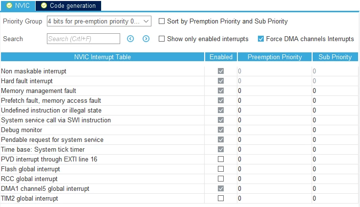

0693W00000FCxbKQAT.pngNVIC by default

waclawek.jan
October 19, 2021
IMO this is simply DMA not succeeding to fill the new value to CCRx in timely manner. Try increasing system clock frequency, or set APB divider to 1, or both.
PTai
PTaiAuthor
October 20, 2021
Hi JW, thank you for your reply.
Could you show me the documents or application note talk about "DMA not succeeding to fill the new value to CCRx in timely manner" ?
I want to learn more.
BR!
waclawek.jan
October 20, 2021
Read AN2548.
