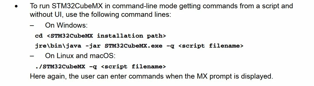

> the docs say you can do this via a script using ./STM32CubeMX -s yourscript.
Clicking the "Help" menu in CubeMX launches UM1718, which tells me that to run in command-line mode using a script​, without UI, you should use
./STM32CubeMX -q yourscript
(with -q not -s). I tested it on linux, and it works.
If you create the following script
help
exit
...and run it, you'll get a list of scripting commands. They are also documented in the UM1718 help document, but that may get stale over time.
> The solution as provided in threads from 2019 is to do: "java -jar /path/to/STM32CubeMx -q yourscript". Why are the > docs still wrong / why is this workaround still required when this has been a reported issue for 4 years?
As stated above, docs seem to be up-to-date.

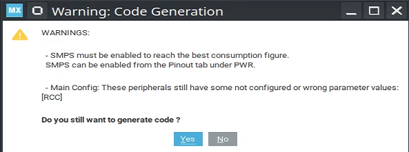

> when running it on the local machine I see a small gui progress bar, and then a dialogue box pops up asking if I'm sure > I want to generate the project.
Inside X, I also get a progress bar, but no dialog or prompt requiring interaction (maybe it depends on your script or project state?). But with Xvfb there's of course nothing and it still works. I was able to generate a project from a ioc with a script (in the virtual console, using xvfb). I also tested that user modifications are preserved.

The dialogue box I get is a warning about incomplete peripheral configuration:
Which admittedly is something that might go away once I've finished setting up my project, although I've spent some time looking for these issues and haven't solved them yet. So maybe it's a non-issue, but it doesn't fill me with confidence that my script could just block waiting for confirmation if something changes.
exactly. If you get these errors while generating from the GUI, you can't expect them to disappear simply because you're  generating in headless mode.
$ timeout 2 sleep 1 || echo error
[Nothing]
$ timeout 2 sleep 3 || echo error
error
