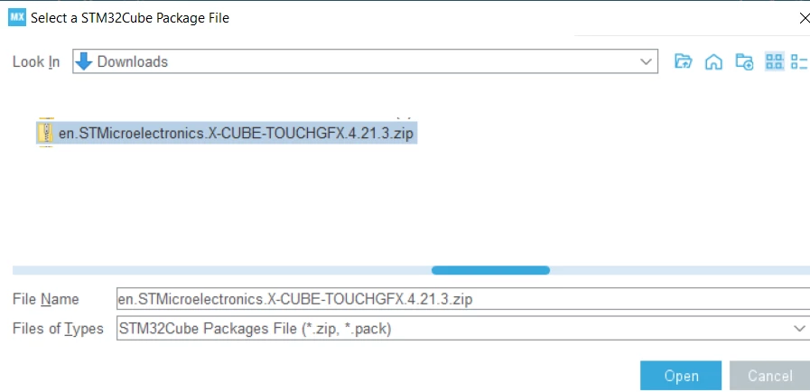

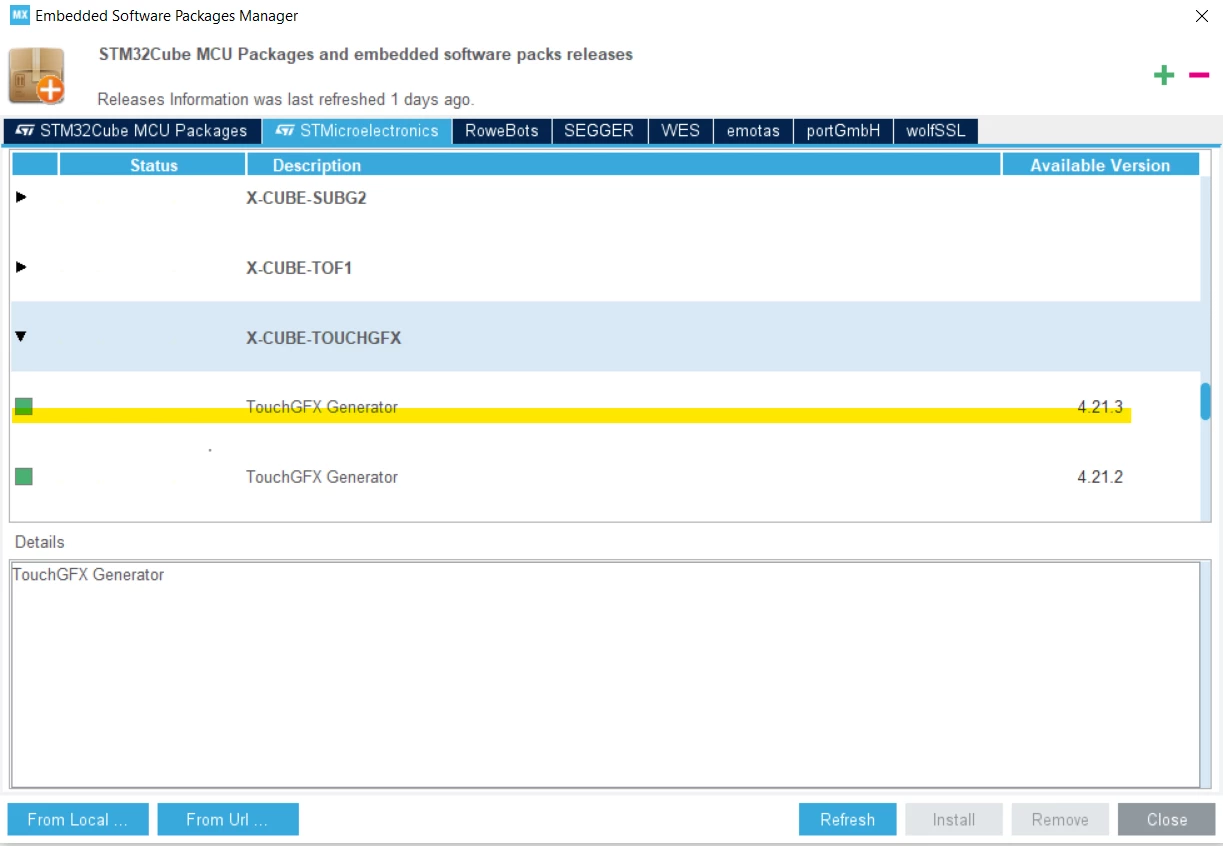

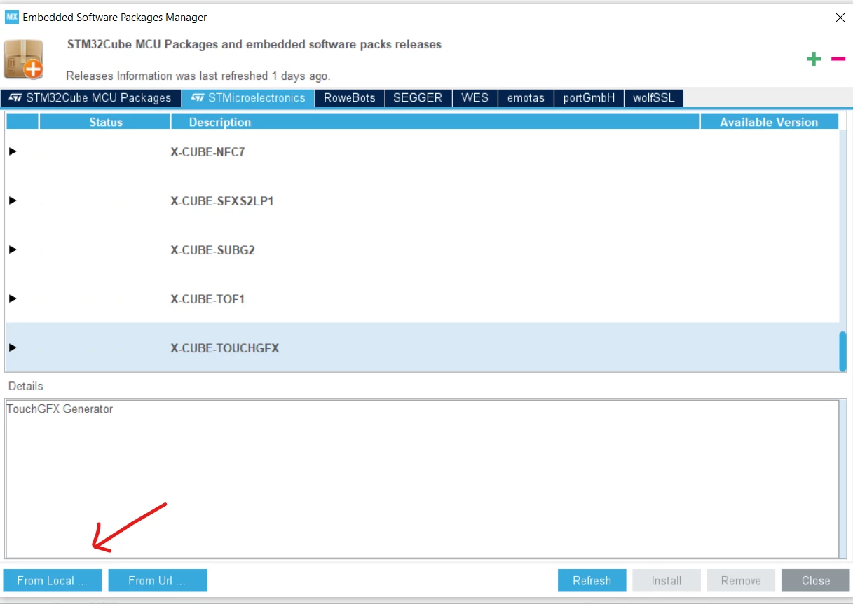

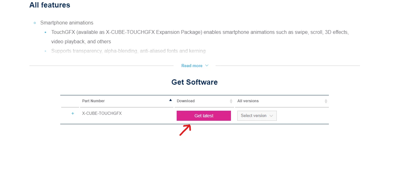

Osman SOYKURT
Osman SOYKURTBest answer
March 24, 2023
Hello TLang.5,
You should be able to get this up running by following these steps :
1- Navigate to this link: X-CUBE-TOUCHGFX - TouchGFX advanced and free of charge graphical framework optimized for STM32 microcontrollers - STMicroelectronics
2- At the bottom, click on download the latest version :
0693W00000aJdVQQA0.png3- Open STM32CubeMX > Help > Manage embedded software package
4- Click on "From Local" and select the zip file dowloaded at step 1.
5- Accept usage license (popup during installation)
6- Check if the X-CUBE-TOUCHGFX 4.21.3 is installed
/Osman
TLang.5
TLang.5Author
March 24, 2023
Hi Oskt,
step 4, to call TouchGFX.zip by clicking the "From Local ..." button is important. I have done it directly by clicking the zip-file in the download area. That does not work!
Many thanks
