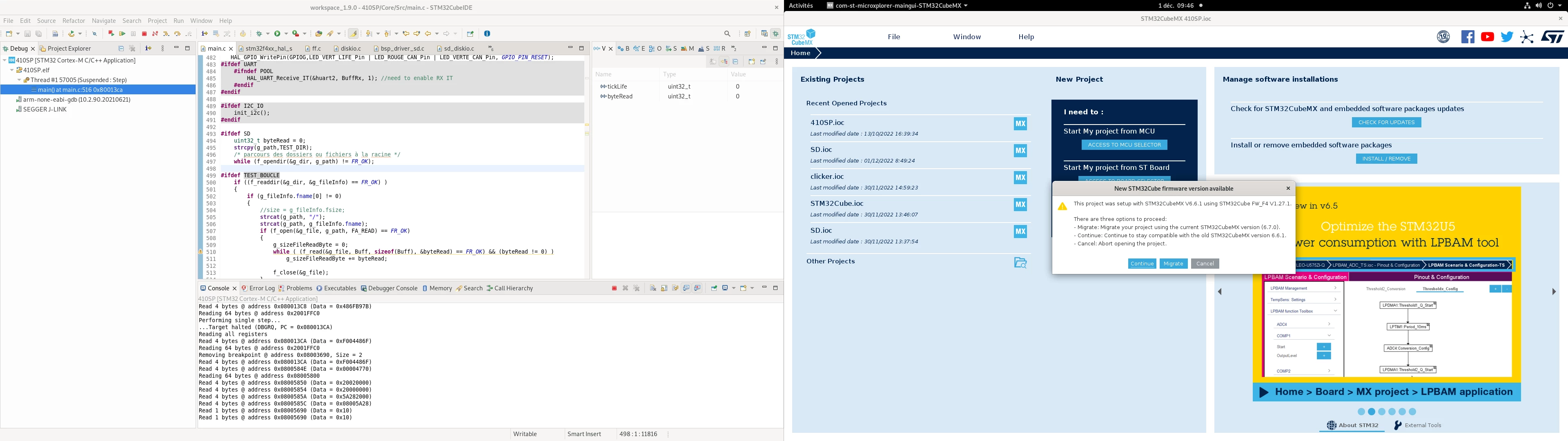

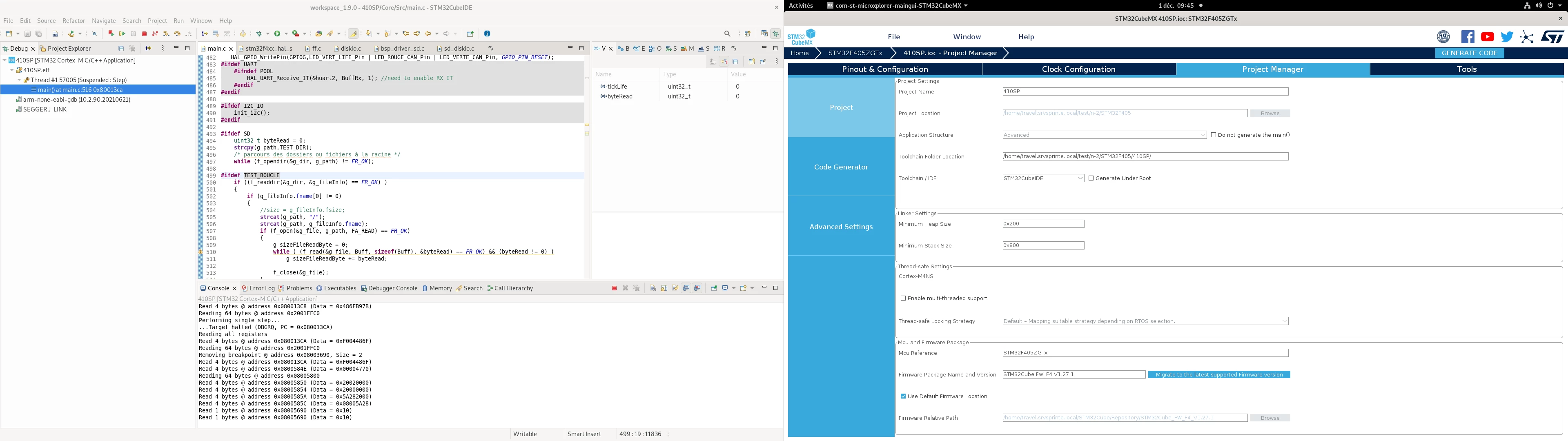

update:
  • i have old project with CubeMx 6.6.1 in STM32F405 with SD 4wire fatfs no DMA, clock divider 20 :
MxCube.Version=6.6.1
  • MxDb.Version=DB.6.0.60
  • old param default: NO HW control, rising...
  • f_mount with no force, and opendir after.
if i migrate to the new CubeMx 6.7.0, regenerated software and doesn't works.
i passed 3 days to search and i will continue to find problem.
