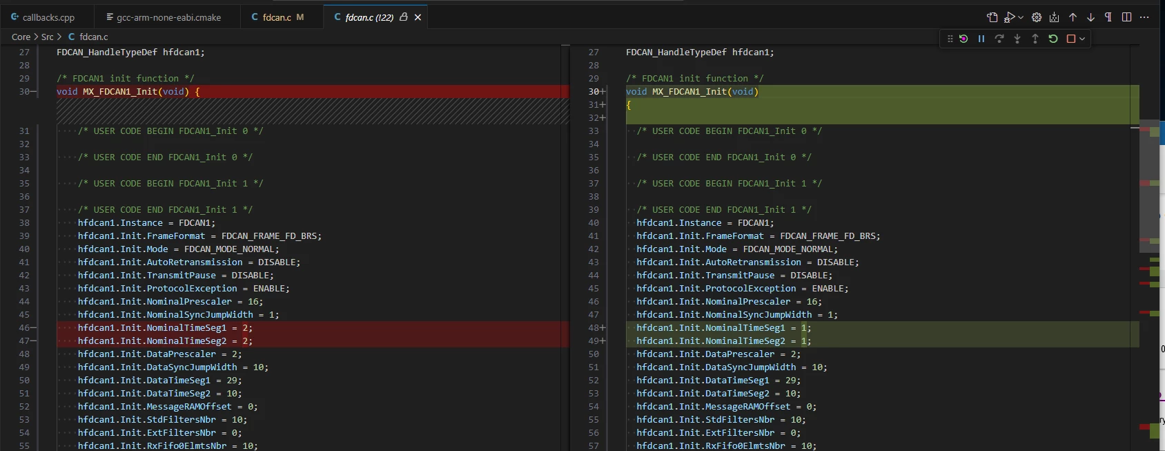

So tha problem is that during the cubemx update the NominalTimeSeg parameters were changed.

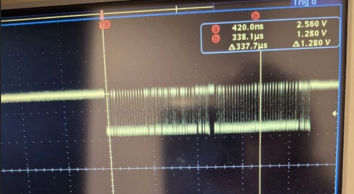

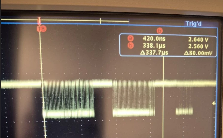

Of course, I’ve checked what’s happening on the line. The transaction looks incorrect, which is causing the stuffing error I’m observing. This issue only occurs after migrating the project from STM32CubeMX 6.12.1 and FW_H7 1.11.2 to STM32CubeMX 6.13.0 and FW_H7 1.12.1.
Here you can see how it looks before the update:
And here it is after the update:

Doesn't your scope have a means to download screenshots - rather than take blurry photos?

January 6, 2025
I don’t think the post you mentioned has anything in common with my issue. The Nominal Time Seg1 and Nominal Time Seg2 were correct and set to 2. However, after I updated the CubeMX version from 6.12.1 to 6.13.0, these parameters were magically changed to 1 :)
