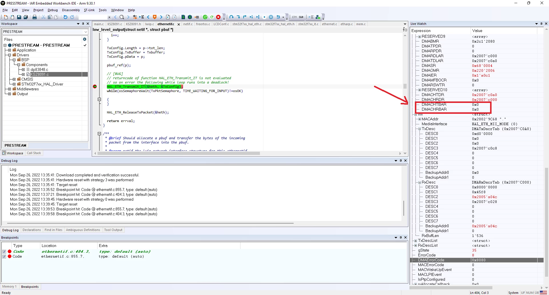

2. A Bug in generated function "low_level_output" in module "ethernetif.c": return code of transmit function not evaluated and following while loop runs into deadlock after error
static err_t low_level_output(struct netif *netif, struct pbuf *p)
 // [BUG]
 // returncode of function HAL_ETH_Transmit_IT is not evaluated
 // so on error the following while loop runs into a deadlock!
 HAL_ETH_Transmit_IT(&heth, &TxConfig);
 while(osSemaphoreWait(TxPktSemaphore, TIME_WAITING_FOR_INPUT)!=osOK)
 HAL_ETH_ReleaseTxPacket(&heth);
 return errval;
3. After starting ETH a fatal bus error occurs in ETHDMA - probably the DMA descriptors are configured incorrect for STM32F7 (copy and paste from STM32H7 with different behaviour?)

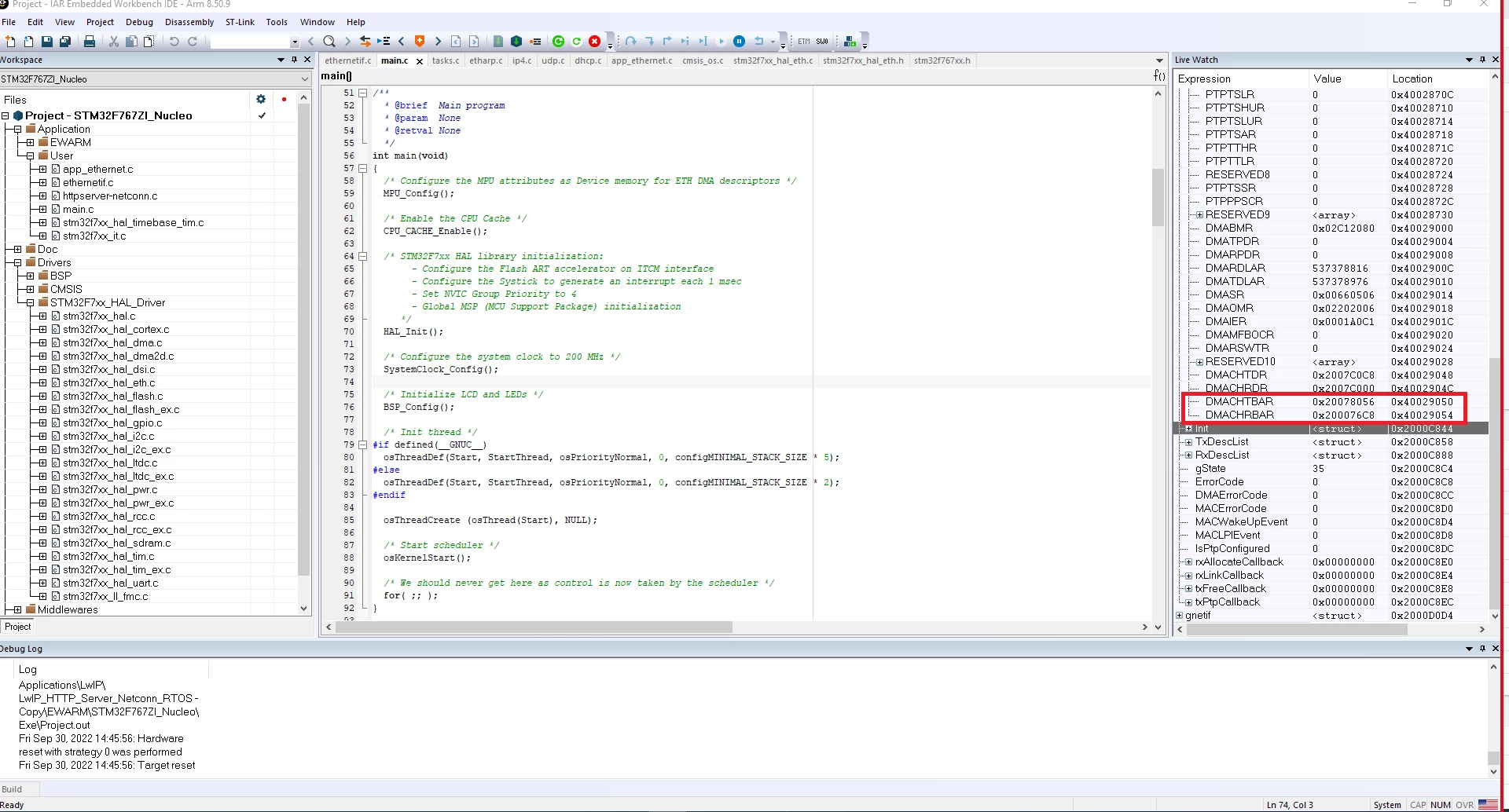

About point 2, the error seems to be caused by the missing configuration of DMA Rx and Tx buffers.
0693W00000UFXQ2QAP.pngThe following screenshot is the output of the the FW example that is placed under :
C:\Users\<UserName>\STM32Cube\Repository\STM32Cube_FW_F7_V1.17.0\Projects\STM32F767ZI-Nucleo\Applications\LwIP\LwIP_HTTP_Server_Netconn_RTOS.
0693W00000UFXRyQAP.pngPlease check your configuration and if you face any issue, don't hesitate to get back to me. It would be also helpful if you share your project so that we can help you solve the issue.
The timeout variable TIME_WAITING_FOR_INPUT is set to 0xFFFFFFFF (INFINITE). So this will run into a deadlock on previous errors indeed.
This would be better style:
 errval = HAL_ETH_Transmit_IT(&heth, &TxConfig);
 if (errval == HAL_OK)
I've compared my autogenerated CubeMX project with your given example project. It seems to be a problem with cache configuration. With disabled D cache there is no Fatal Bus Error (FBE).
In your example in MPU some ETH memory areas was configured with disabled cache manually. In CubeMX this MPU configuration is missing and clean/invalidate cache functions are not implemented completely. So the autogenerated by CubeMX code is wrong.
I've attached a modified file ethernetif.c, that works for me now.
  • placing ETH descriptors in DTCMRAM (without cache)
  • set MEM_ALIGNMENT in lwiopts.h to 32 bytes for cache alignment
  • calling SCB_CleanDCache() in function low_level_output (better only cleaning single variables/buffers with SCB_CleanDCache_by_Addr, but not sure which)
But all the changes in ethernetif.c will be lost with next CubeMX regeneration.
Maybe it helps to revise this file.
