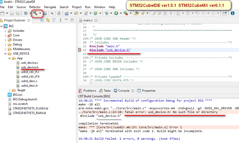

Before that there was STM32CubeIDE ver1.4.0 STM32CubeMX ver6.0.0 everything was fine.
Installed STM32CubeIDE ver1.5.1 and STM32CubeMX ver6.1.1, there was an error when connecting USB_DEVICE.
Tried creating a project from scratch with nothing but USB_DEVICE. Gives an error message.
What to do?

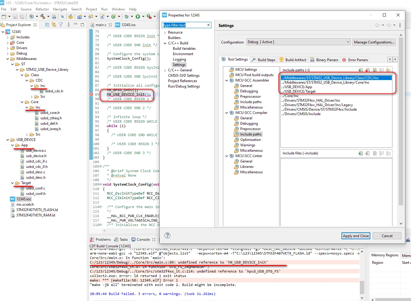

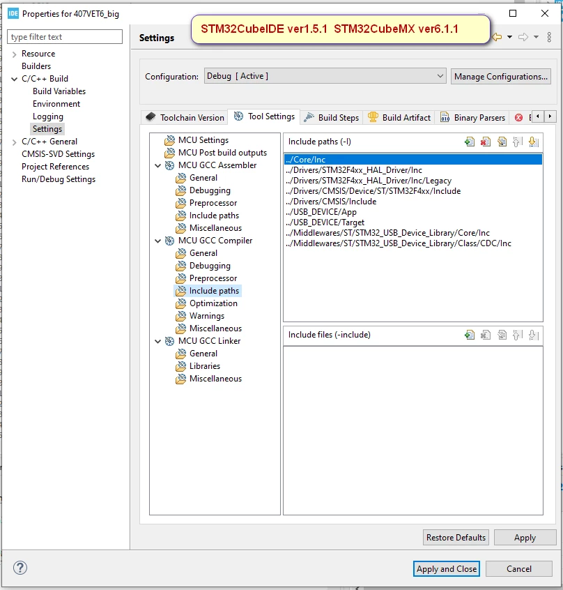

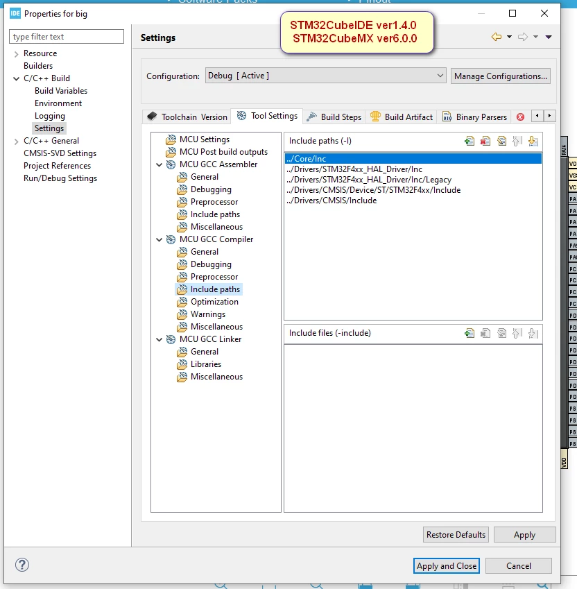

Check your include directories
Project properties -> C/C++ Build -> Setting -> Tool Settings -> MCU GCC Compiler -> Include Paths
ADysh.1
ADysh.1Author
January 16, 2021
Added everything. It didn't get any easier. Error again!
0693W000007BXRjQAO.pngI specifically looked at the settings on the old version. The settings on both the old and the new version are the same. But the new one doesn't work!
January 16, 2021
Different error message. It sees the file now. The init function should be within main.c. Regenerate the code. If that doesn’t work, attach your IOC file.

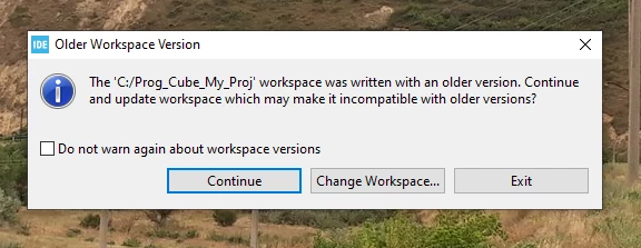

January 16, 2021

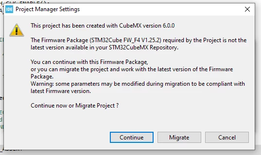

1) I'm launching a new version of STM32CubeIDE ver1.5.1 (STM32CubeMX ver6.1.1).
I indicate the directory with the old project on STM32CubeIDE ver1.4.0 STM32CubeMX ver6.0.0.
At startup it says: “The workspace was written with an older version. Continue and update workspace which may make it incompatible with older version? ".
0693W000007BXbyQAG.pngI click Continue.
An older version message appears.
0693W000007BXc8QAG.pngI click Continue.
The project opens and works as expected.

0693W000007BXcDQAW.png2) I click to create a new project.
I indicate the same chip.
USB only settings in virtual com port mode.
I generate a project.
Checking - again the same error!
Attach the IOC file.
Half a day was wasted. The new version does not work as expected out of the box. Very upset. I roll back to STM32CubeIDE ver1.4.0 STM32CubeMX ver6.0.0. Extremely disappointed.

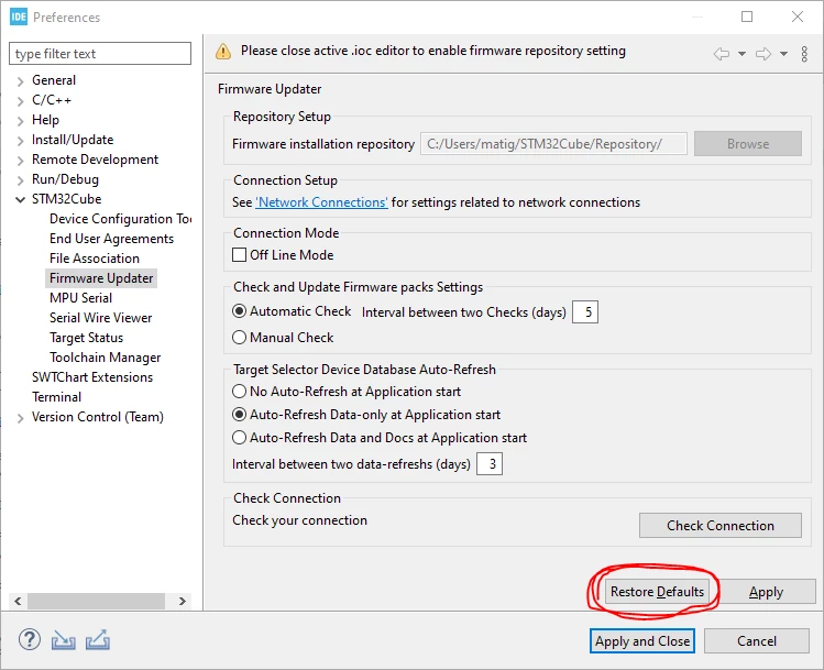

So I went on to change the repository path, which you can do using "Window -> Preferences -> STM32Cube -> Firmware Updater -> Firmware installation repository"
You might as well want it fixed for CubeMX, "Help -> Updater Settings -> Repository Folder"
I changed it to "C:\ST\Repository"
Changing it as you might have guessed would not move the files, but it will redownload everything next time you try to build or codegen.
If this doesn't help, maybe you could further look into the logs file for clues..

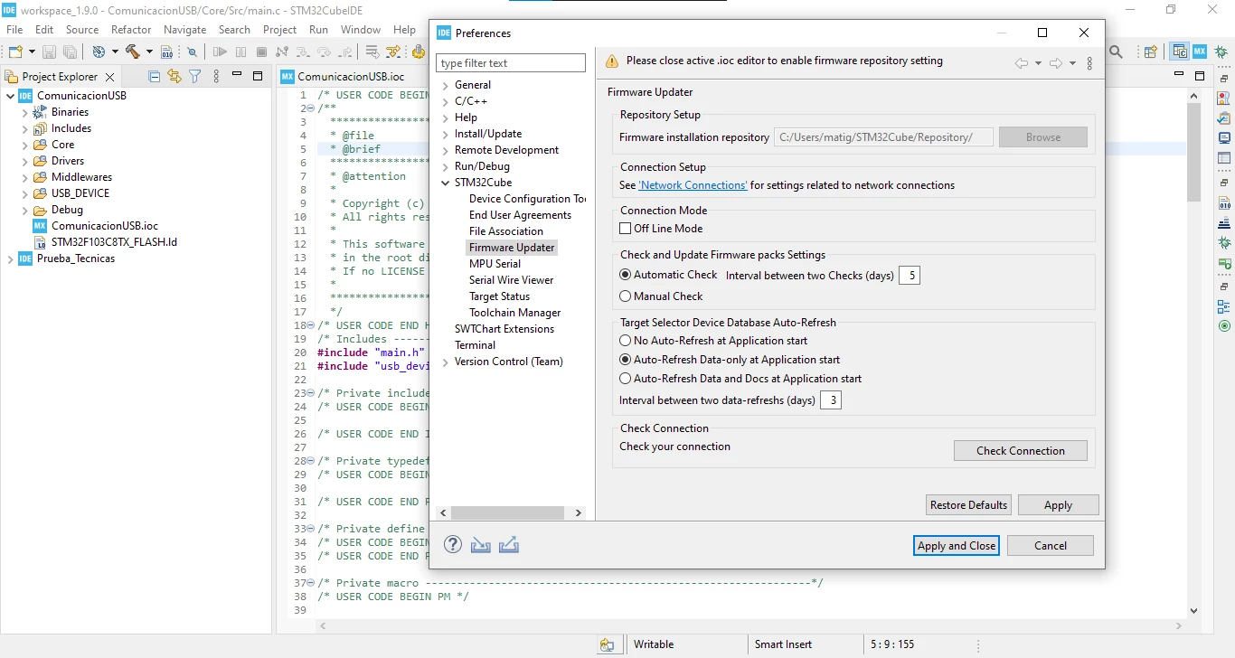

I had the same problem with CubeIDE 1.9.0. I was looking for the solution for several hours until I saw the suggestion of @IPaku.1​ and finally I could solve the problem. In order to solve it I did the following:
Inside the CubeIDE I went to "Window -> Preferences -> STM32Cube -> Firmware Updater"
0693W00000QKl9YQAT.pngIf you have the same problem, it is probably because at some point you changed the address of "Firmware installation repository". I say this because when I had done that, the problem started.
The solution was click on "Restore Defaults" then "Apply and Close" and finally create a new project.
0693W00000QKlBjQAL.pngI hope you can solve it too. Good luck!
