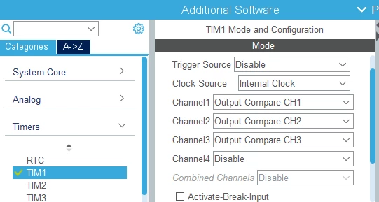

I am configuring the 3 of TIM1's channels as Output Compare:

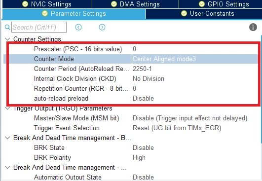

Then i choose the Center Aligned_3 mode and setting the frequency on 16KHz (frequency is correct):
Finally, every channel has the same settings as below:

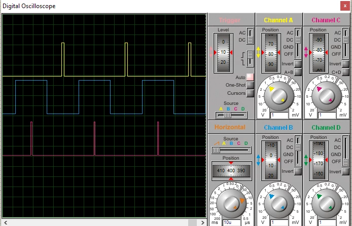

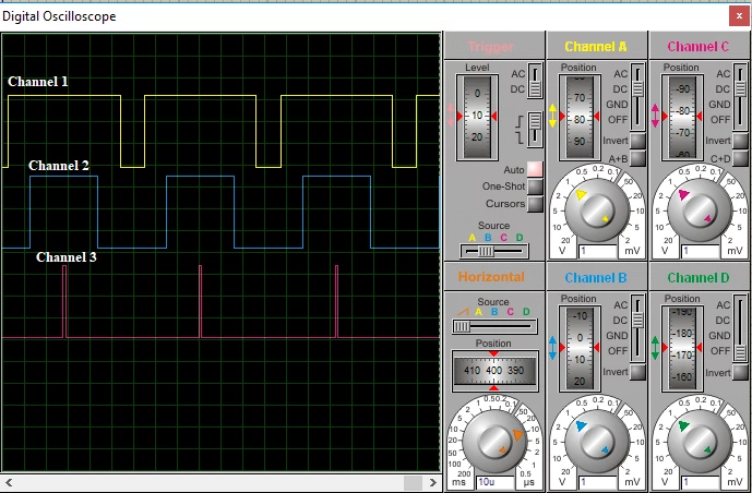

And on simulator everything is correct:
If we change the CCR1 to lower value:
TIM1->CCR1 = 100; //Channel_1 95% Duty Cycle
Seems like Channel 1 is not aligned with the others, like it is shifted:
  • Can someone help me and explain me what i am doing wrong?

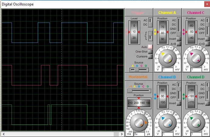

The output looks like this:
