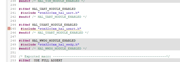

In file stm32c0xx_hal_conf_template.h there are duplicated lines at 239 row.
#ifdef HAL_UART_MODULE_ENABLED
#include "stm32c0xx_hal_uart.h"
#endif /* HAL_UART_MODULE_ENABLED */

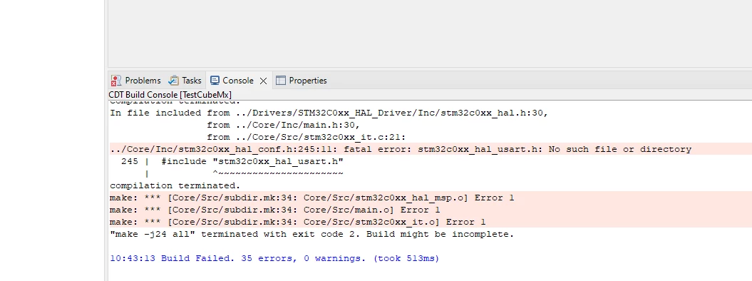

if you are using Cube MX you can't compile.

Can you add more details on the issue. On the stm32c0xx_hal_conf_template.h, i can't see any duplicated lines:
could you add your .ioc file with some description (screenshots,...) So we can reproduce this behavior.
To be duplicated, it must occur twice - so where is the other occurrence?

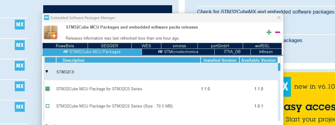

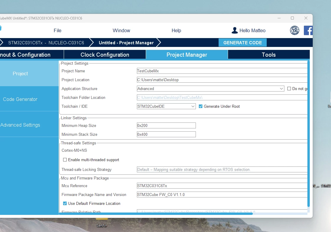

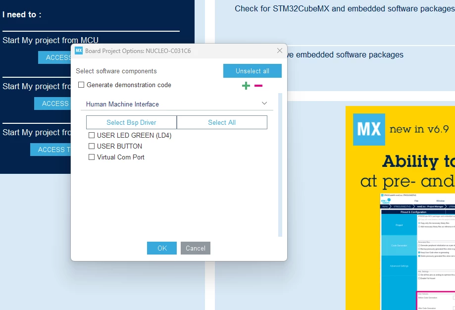

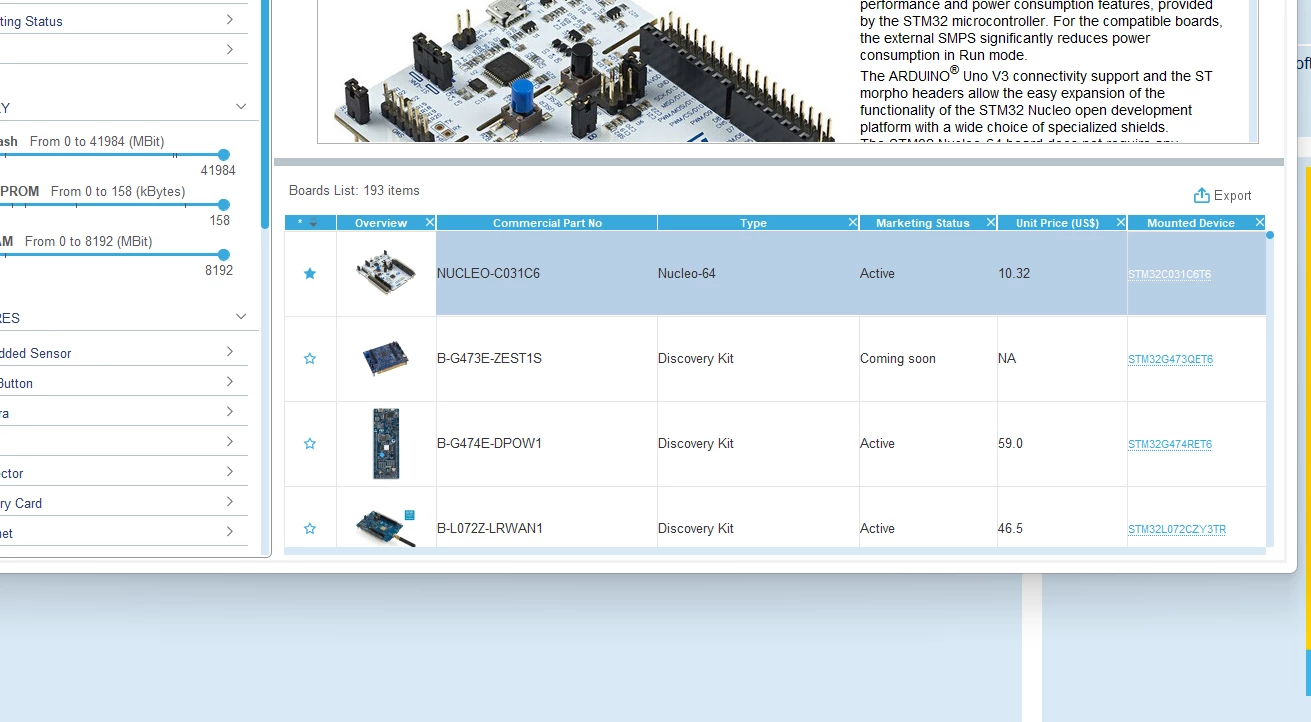

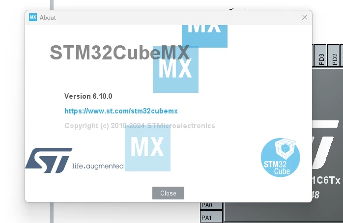

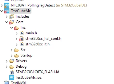

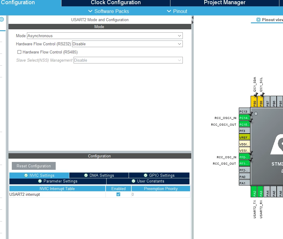

It's right, I've done a mistake. But yuo can't compile if you create a project with Cube mx.. Look:

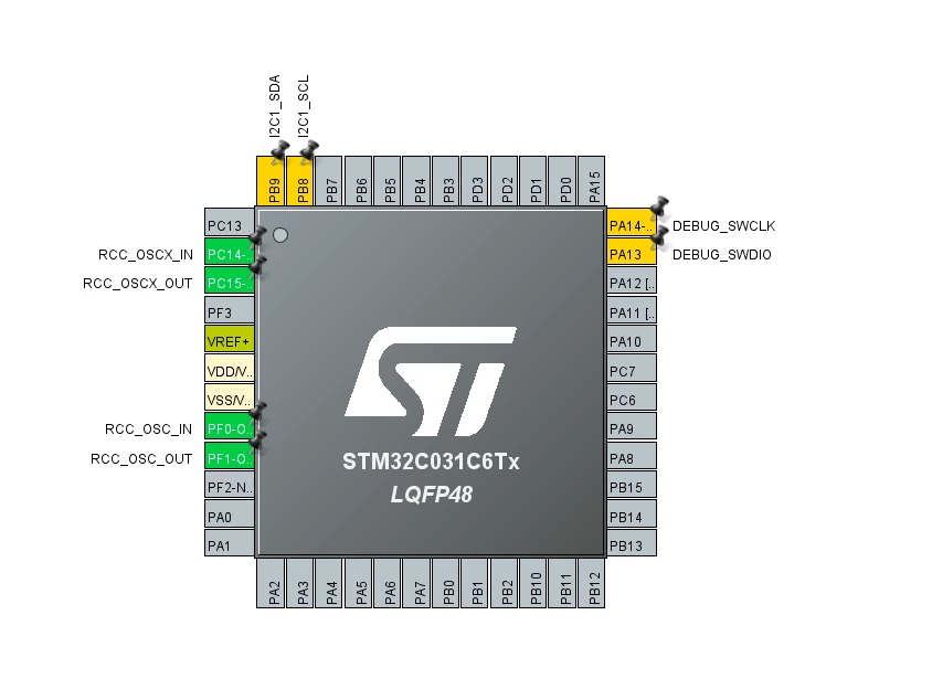

February 25, 2024
And if you reopen ioc file th uart disappear..
Look:

February 25, 2024
Hello @MatteoBandini74
Thank you for reporting this. I confirm the issue and i will escalate it to the concerned team for correction.
An internal Ticket 174573 is created for the tracking of this bug.
(PS: Ticket 174573 is an internal tracking number, not accessible by customers and usable for internal tracking).
Thanks again for your question.
Best Regards.
