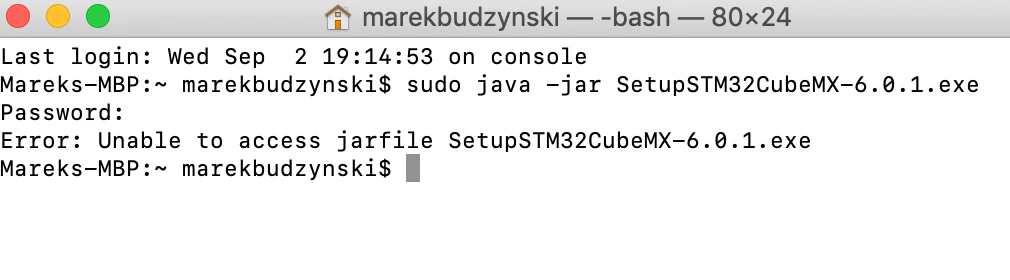

MBudz.1
Aug 16, 2020 8:28 AM UTC
Problem installing on Mac Best Answer

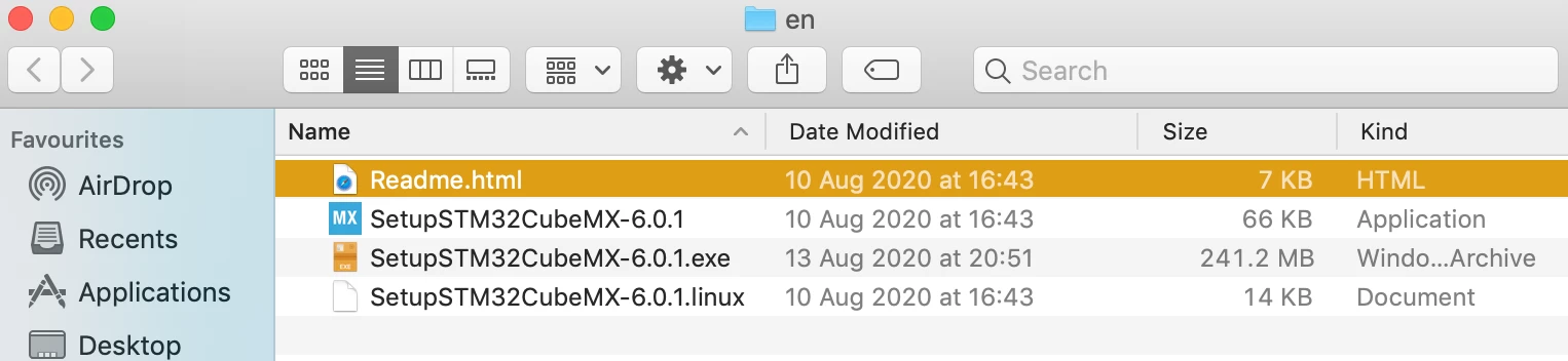

0693W000003PPG6QAO.pngDownloaded and installed the latest Java development kit. Tried installing SetupSTM32CubeMX-6.0.1 via: sudo java -jar SetupSTM32CubeMX-6.0.1.exe but get this error message: Error: Unable to access jarfile SetupSTM32CubeMX-6.0.1.exe .
Any ideas?

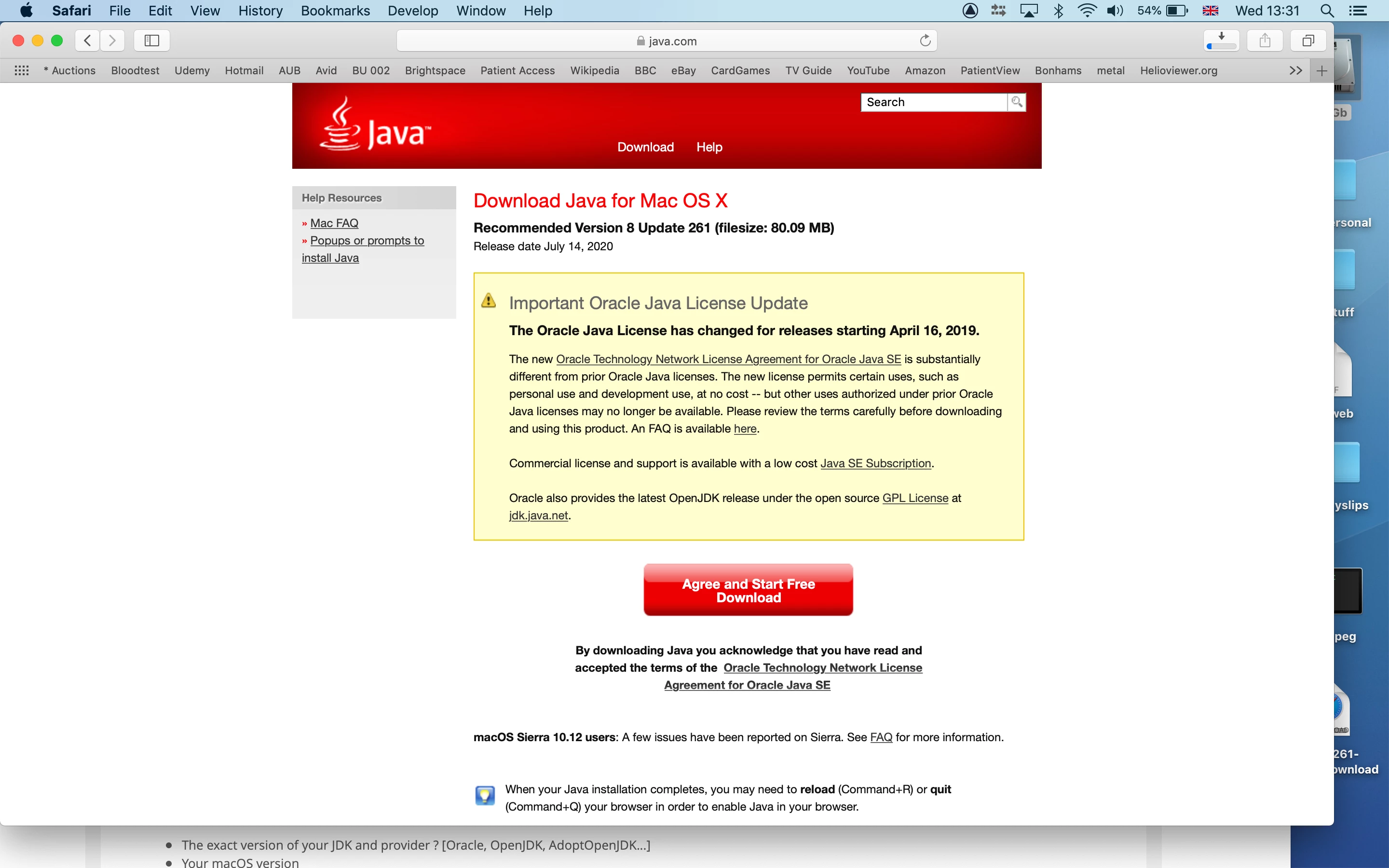

Aymen CHAKROUN
Sep 2, 2020 11:50 AM UTC
Hi @MBudz.1​ ,
Can you please give us:
  • The exact version of your JDK and provider ? [Oracle, OpenJDK, AdoptOpenJDK...]
  • Your macOS version
Are you facing issue when you double click the SetupSTM32CubeMX-6.0.1.app ?
Regards,
Aymen.
MBudz.1
MBudz.1Author
Sep 2, 2020 12:39 PM UTC
0693W000003QYuvQAG.pngHello,

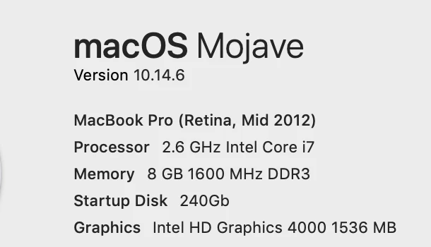

Thanks for replying. I'm running Mac OS 10.14.6 and downloaded the latest Java:

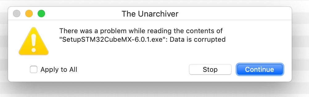

Bit doesn't recognise the .exe file and says the the data is corrupted:0693W000003QYz7QAG.png

Hi @MBudz.1​ ,
I tried with the same macOS verison 10.14.6 (Mojave), but I can't reproduce your issue.
Can you try installing Oracle JDK and not JRE ?
Because STM32CubeMX works fine only with JDK and not JRE in macOS environment.

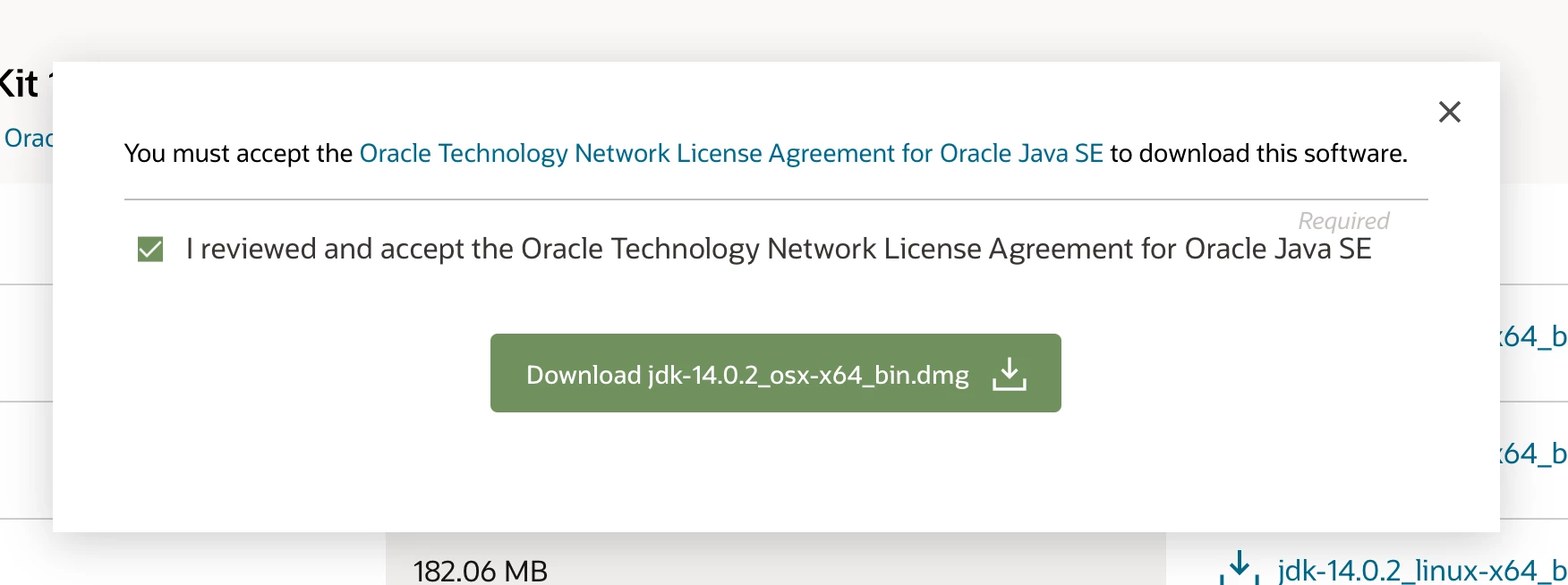

MBudz.1
MBudz.1Author
Sep 2, 2020 6:13 PM UTC
That's interesting I downloaded and installed this:0693W000003QbPIQA0.png

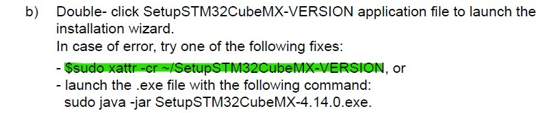

Aymen CHAKROUN
Sep 3, 2020 6:58 AM UTC
Hi @MBudz.1​ ,
Can you apply this command [to bypass Gatekeeper]:
Extract from STM32CubeMX User Manual:
Just one clarification, you need to double click the .app file and not .exe file to start STM32CubeMX
The .exe file is only used with command line 'java -jar'
Regards,
Aymen.

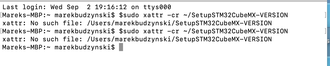

MBudz.1
MBudz.1Author
Sep 3, 2020 8:19 AM UTC

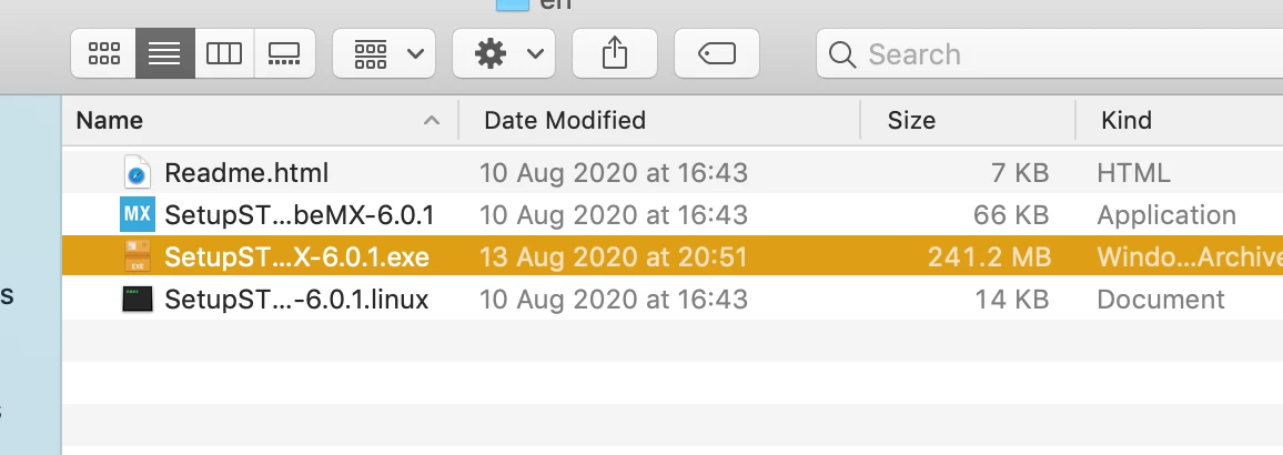

I did double click the ,app files and it won't open when I double click it.
I tried using this and it gave me an error message:
Then I tried this:
Still can't open it.
Any other ideas?
Aymen CHAKROUN
Sep 3, 2020 8:48 AM UTC
Hi @MBudz.1​ ,
My Screenshots was for any MX VERSION, you need to change the VERSION by the correct one.
So in your case:
sudo xattr -cr ~/SetupSTM32CubeMX-6.0.1
Also, try doing the java -jar without sudo:
java -jar SetupSTM32CubeMX-6.0.0.exe
Regards,
Aymen.

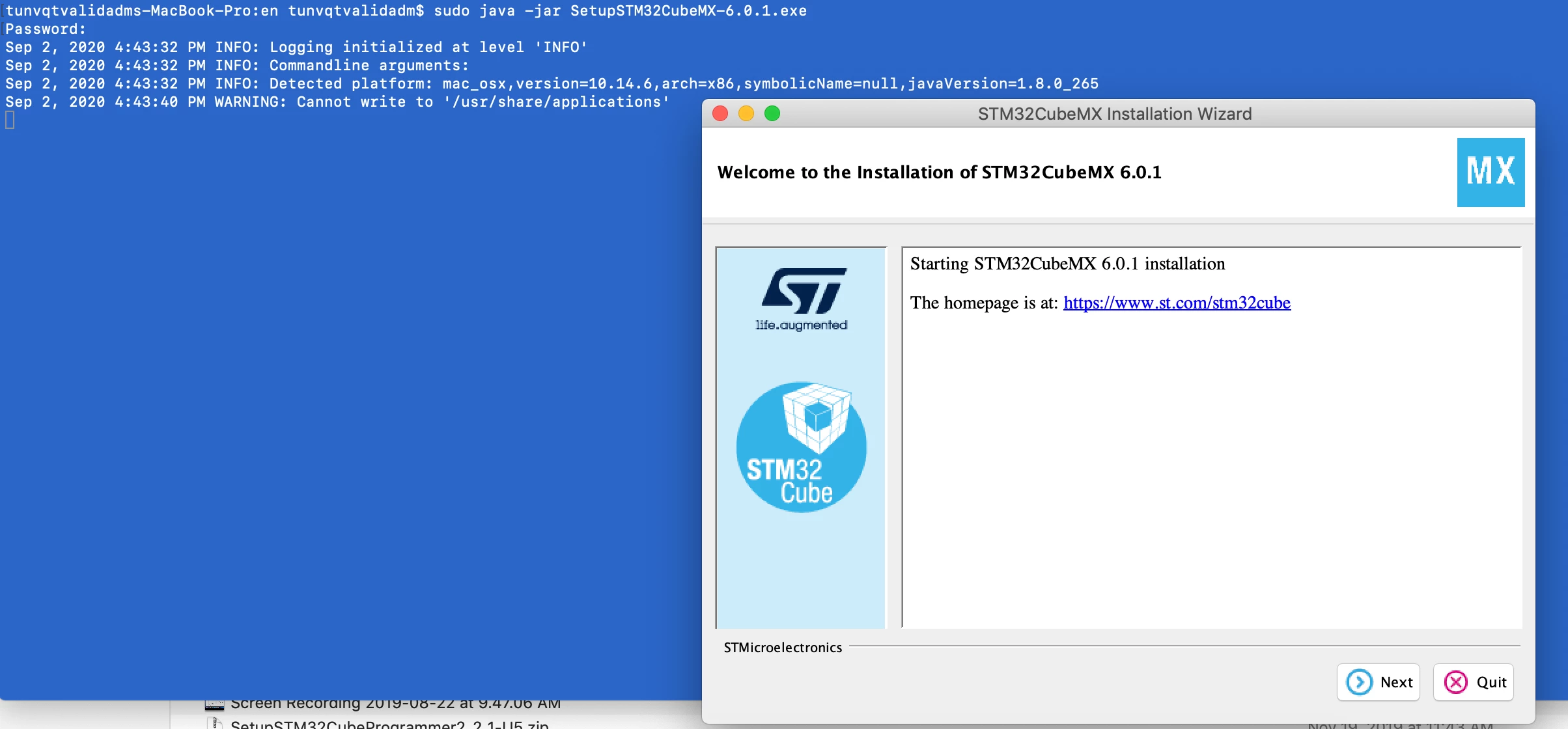

MBudz.1
MBudz.1Author
Sep 3, 2020 9:16 AM UTC
Got it to work. Thanks for all of your help.
