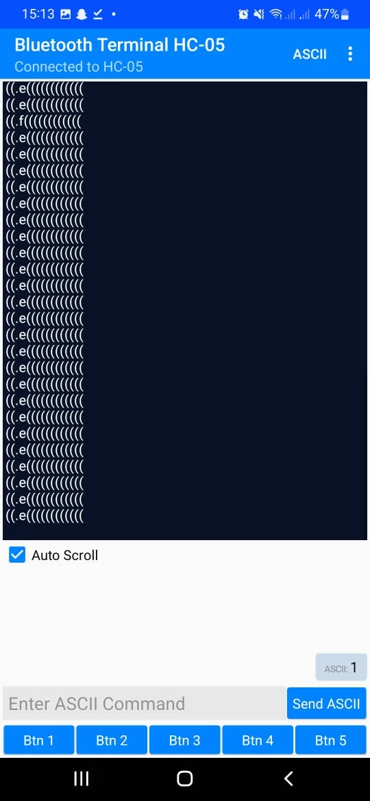

I'm having trouble with ADC2 and ADC3 on my NUCLEO-L010RB board. I've utilized all 16 ADCs on the microcontroller, and the code is functioning correctly except for these two ADCs. I am using LPUART.
In this image, I obtained a reading of 40 from all the sensors connected to ADCs, corresponding to the ASCII character "(". However, ADC2 and ADC3 consistently display the same value, even when I modify the input to any value other than 40. These two ADCs persist with this issue.

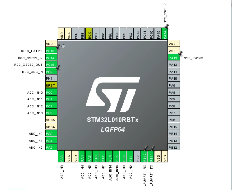

This is the configuration.

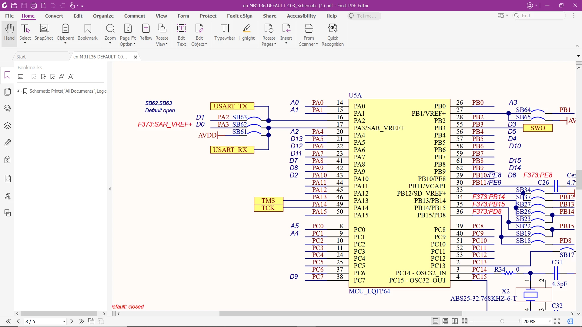

You need to disconnect STLINK-VCP from your MCU by desoldering SB14 and SB13 and solder solder bridges SB62 and SB63:

i can't send the code but after conducting numerous tests, I've discovered that ADC inputs IN2 and IN3 behave as USART inputs, even when I select ADC mode as indicated above.
MinaihabAuthor
May 3, 2024
How to Change the solder bridges SB62 and SB63 to allow the ADC in2 and in3 to work as ADCs?
MinaihabAuthor
May 7, 2024
Thanks, I found the answer to my question, and I thought that the problem would be solved. I will ask again if there are any issues after desoldering SB14 and SB13 and soldering solder bridges SB62 and SB63.
