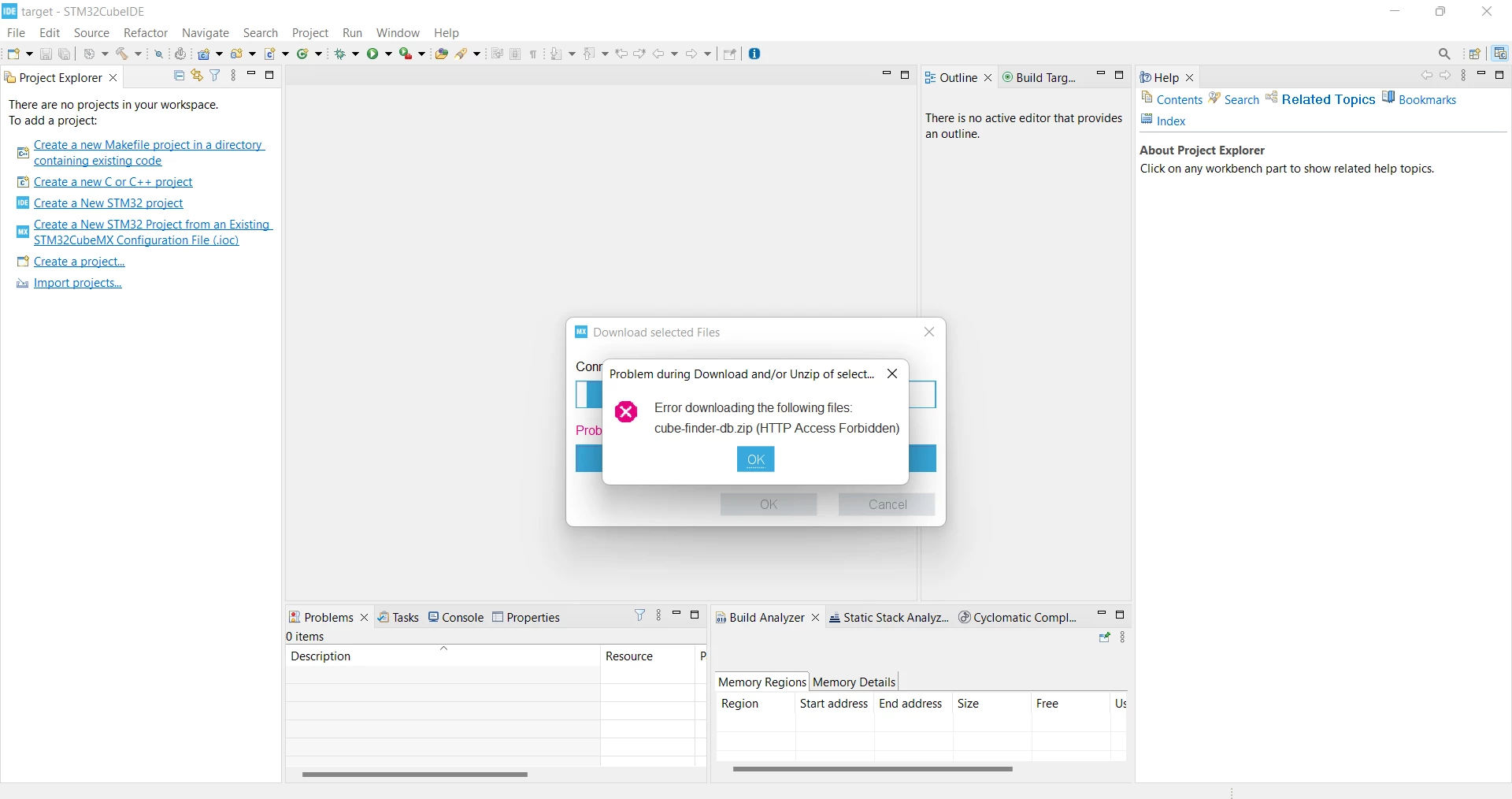

Problem during download - access forbidden. Not able to download cube finder db. How to manually add a MCU library?

Hello @Roberto Peruzziniradheep​ ,
Make sure to use CubeMX with admin right.
Please have a look at this post, it may help you.
Don't hesitate to come back here with update.
When your question is answered, please close this topic by choosing Select as Best.
Imen
Pavel A.
May 25, 2023 6:29 PM UTC
This is a very strange advice. The finder db is under the user profile directory. CubeMX should never require admin rights (or elevation).
If the machine is under a company management (internet filtering, some "security" software installed...) - ask your IT.
