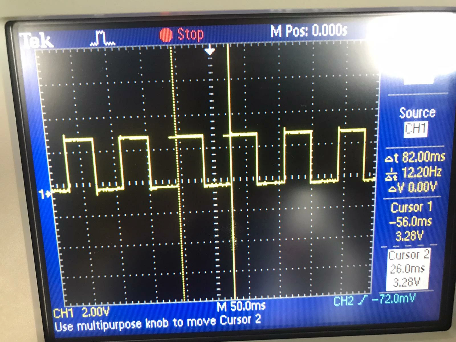

Now eventhough APB1 Timer Clock is 72 MHz. Prescaler is 0 and Counter Period is 359. The frequency of the PWM is 12 Hz. I use blue pill STM32. What might be the cause . I know it is a little bit irrelevant from the topic but I didn't want to open a new topic for that.
berendi
Principal
May 27, 2020
Please post the contents of the RCC and timer registers.
waclawek.jan
May 27, 2020
How do you know?
GunkutA
GunkutAAuthor
May 27, 2020
I look it with oscillscope. here is the view:

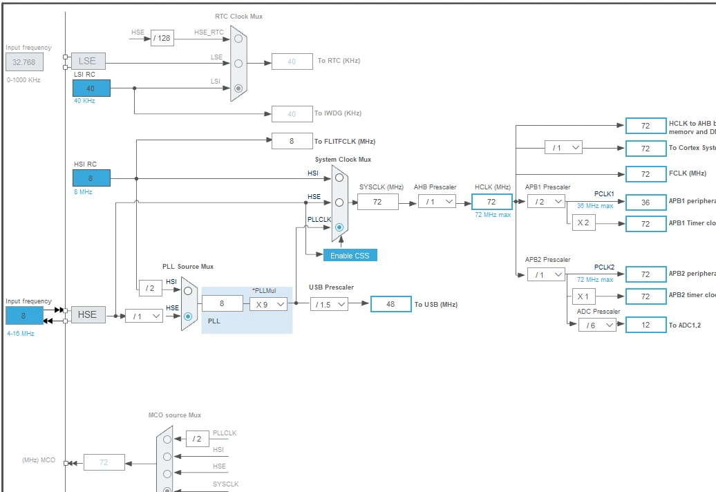

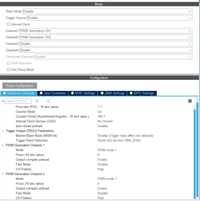

GunkutA
GunkutAAuthor
May 27, 2020
Here they are from CubeMX
Clock Config Screen
berendi
Principal
May 27, 2020
No, the contents of the hardware registers. Cube screenshots and and source code containing HAL function calls are useless for troubleshooting.
