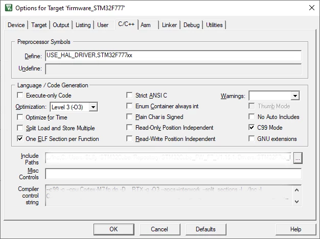

Pre_Include_Global.h(27): warning: #47-D: incompatible redefinition of macro "USE_HAL_DRIVER"
What's with this warning, and how do I avoid it (apart from commenting it out). Is there something that I'm doing in error in STM32CubeMX?
I'm using Keil uVision V5.33.0.0 with an STM32F7 processor.
Andrew Neil
Andrew NeilBest answer
May 5, 2021 10:53 AM UTC
It's exactly what it says: At that point, you already had a definition of "USE_HAL_DRIVER" - and you've re-defined it as something different.
The build output should also tell you where the previous definition was.
So look at the two definitions, and decide which one is the one you want.

BLill.2
BLill.2Author
May 5, 2021 3:24 PM UTC
I guess that makes sense, but the problem is that apparently STM32CubeMX dumps it into the project options when the code gets generated. The only other place it occurs is in Pre_Include_Global.h.
I'll just rip it out of the project options and go from there.
Thanks
