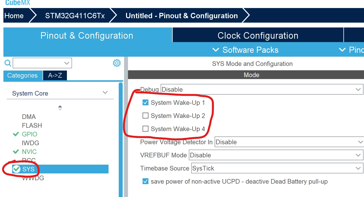

power and thermal option is not available for STM32G474xx devices in STM32CubeMx
STM32CubeMx version is 6.12.1.
The power and thermal option is not available for STM32G474xx devices project in STM32CubeMx.
The same is available for the STM32U5Xxx devices project.
How to set the wake-up modes if the power and thermal option is not available?
TDKBest answer
September 2, 2025
Wake up options are within the SYS tab.
1 reply
TDKBest answer
September 2, 2025
