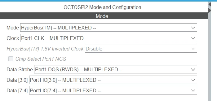

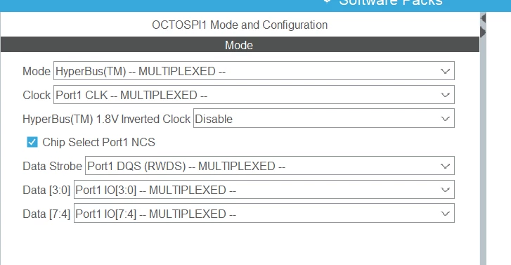

I am trying to configure multiplexed OCTO SPI for the above MCU.
Only Chip Select Port 1 NCS comes up as an alterantive for OCTOSPI1, and for OCTOSPI2 the Chip Select Port is is disabled, I would have expected Port 2 NCS to come up here...
Is this a bug or am I missing something?

Hello @Southbranch,
OCTOSPI2 is enabled if Port1 NCS is selected in OCTOSPI1.
But you won't be able to select Chip Select Port1 NCS in OCTOSPI2 since it is already selected in OCTOSPI1. This is caused by the fact that Port2 is not available with the package.
To further clarify, when using direct mode, only one instance of OCTOSPI will be enabled, the other one will be disabled since in direct mode, using 2 OCTOSPI instances means that each instance will be on a different Port and in this case we have only one Port: Port1 ==> Only one instance can be enabled in direct mode.
When using multiplexed mode, we can enable both instances of OCTOSPI since they will be on the same Port, in this case Port1. So, for NCS signal, it will be enabled in one of the instances (not both).

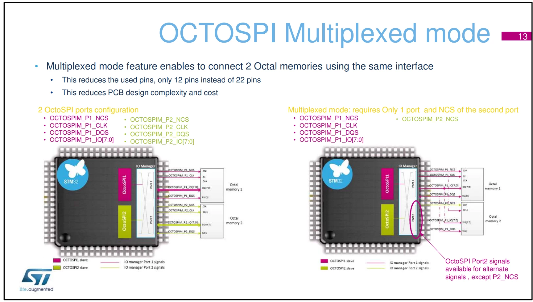

Yes I understand, only one dataport is needed which is the whole idea, but two NCS (Port 1+2) are needed, or have I missed something trivial? Picture to the right below.
A long shot, but what about connecting NCS1 to CS1 and then connecting a logical inverter to CS2 via NCS1? In that case, when NCS1/CS1 goes low CS2 automatically goes high and vice versa. In theory it would then give access to both memories in multiplexed mode using only NCS1.

Hi @Southbranch,
You are right and your understand is correct.
"no need for 2 ports, only one port is sufficient." => I mean only one data port. But we need two NCS: CS for port 1 and CS for port 2 as explained in the below figure from AN5050:
So, Multiplexed mode requires BOTH: OCTOSPIM_P2_NCS and OCTOSPIM_P1_NCS
as mentioned in the RM0468:
OCTOSPIn_NCS are not part of the multiplexing. Only OCTOSPIn_IOs, OCTOSPIn_DQS and OCTOSPIn_CLK / OCTOSPIn_NCLK are multiplexed.
