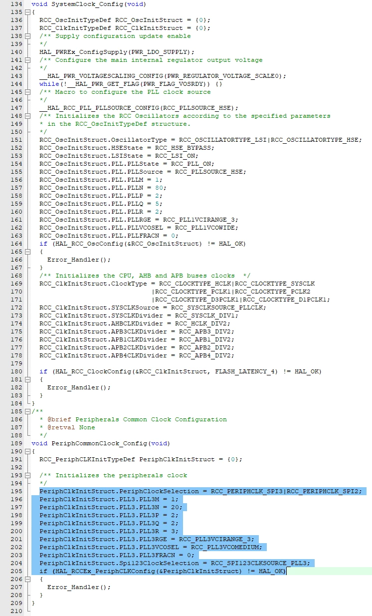

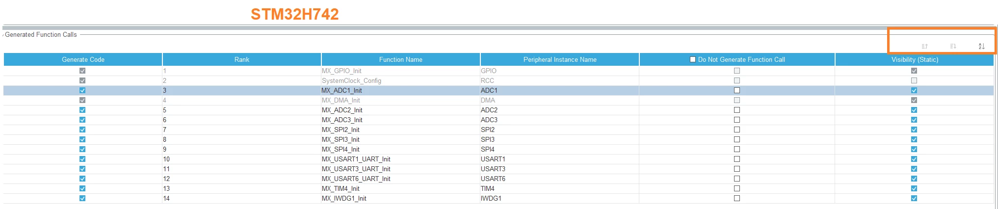

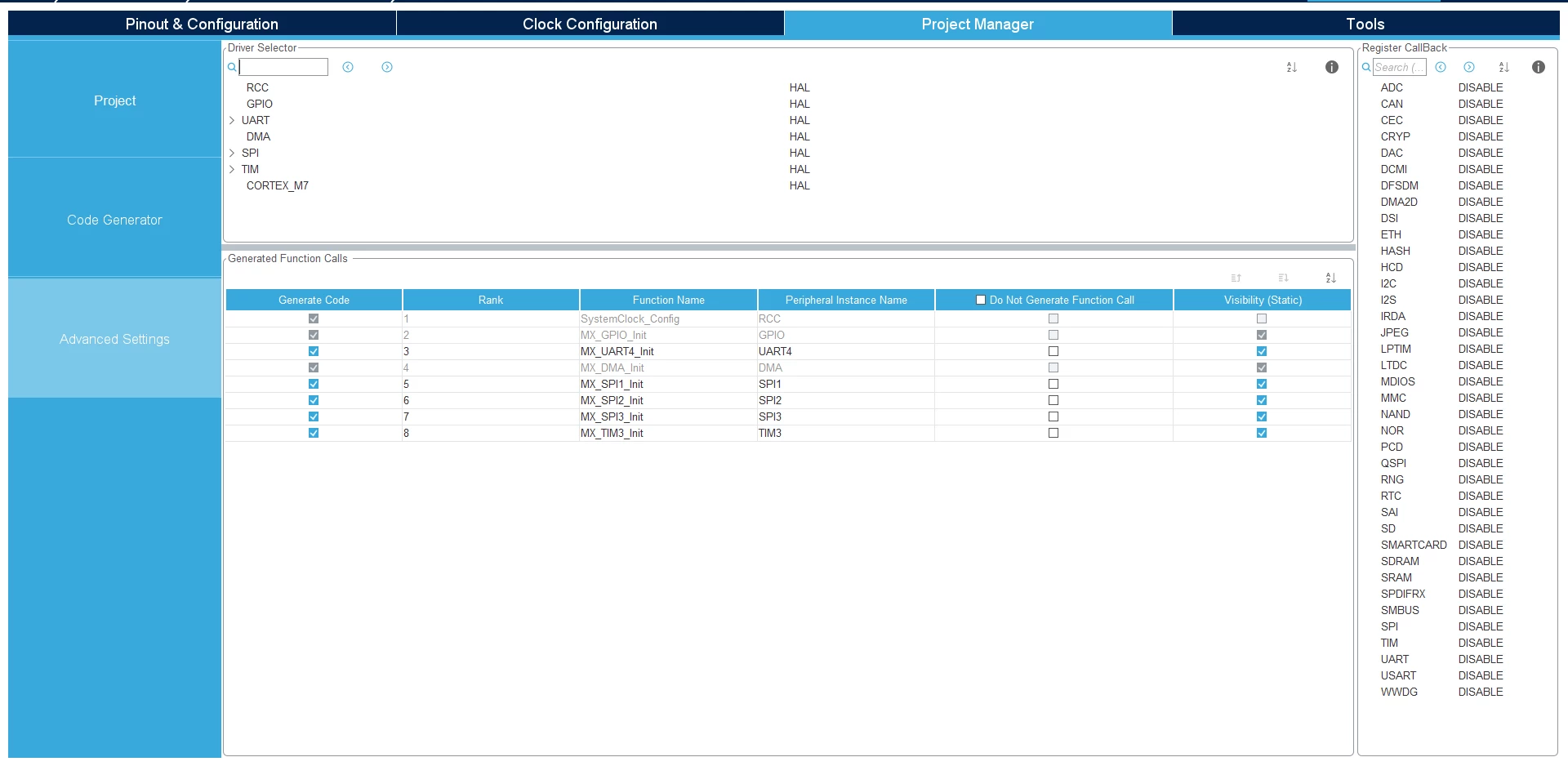

I am using Cube MX to generate a template code for my new project. In Advanced Settings page under project manager tab, Init sub-routines order is not correct and I also cannot fix it. DMA is used in ADC1 and it should initialize before than ADC1_Init. However Cube MX puts ADC1_Init function before than DMA_Init. MX_ADC1_Init order also cannot be changed because order change buttons are not active.

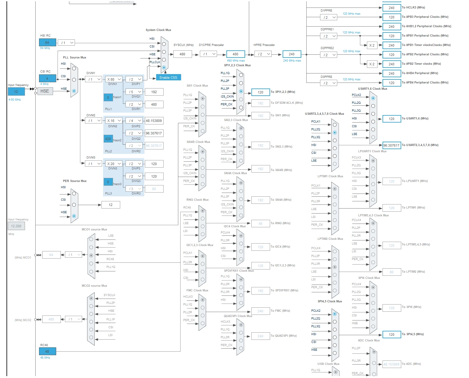

There is a problem with RCC section as well. I reported previously and ST said it is known issue and will be fixed. (https://community.st.com/s/question/0D53W00001Xuay2SAB/adc-clock-setting-in-st-cube-mx-for-stm32h742vgt). However I may find another problem. I genereted a template code using Cube MX and I realized some peripherals clock and PLLs are not set in PeriphCommonClock_Config subroutine. I am not sure whether it is a mistake but I believe it is. There is only settings for PLL3 and SPI123. I am using PLL2Q and some USARTs. Do you think it is a mistake and cube mx should generate code for other PLLS and USARTs as well?

About the DMA init order, it is known issue, it was partially fixed in 6.5.0 and there are still some cases (such as migrating an ioc) where the order is not corrected. The dev team is working on it and it will be properly fixed soon.
The DMA order can be corrected manually from Project Manager view > Advanced Settings tab as explained in this thread.
As for the Clock init, only peripherals using PLL2, PLL3, PLLSAI1, PLLSAI2 as a source clock are configured in PeriphCommonClock_Config() and only when they are used by more than one peripheral. Otherwise the clock init will be generated in HAL_IPNAME_MspInit or in MX_IPINSTANCE_Init.
For USART1,6 for example, the peripheral clock is PCLK2 so it is configured in HAL_UART_MspInit in stm32h7xx_hal_msp.c file.
PeriphClkInitStruct.PeriphClockSelection = RCC_PERIPHCLK_USART1;
PeriphClkInitStruct.I2c3ClockSelection = RCC_I2C3CLKSOURCE_PCLK2;
However, SPI2 and SPI3 share the same Clock mux and it is set to PLL3, so the clock config is done in PeriphCommonClock_Config() in main.c file.
PeriphClkInitStruct.PeriphClockSelection = RCC_PERIPHCLK_SPI2|RCC_PERIPHCLK_SPI3;
Saying that only SPI2 is enabled and only its clock mux is set to PLL3, the clock init will not be generated in PeriphCommonClock_Config(), instead it will be generated in HAL_SPI_MspInit()
In case SPI4,5 clock mux is changed to PLL2Q, this source clock will be used by SPI4,5 and USART2,3,4,... so the clock init will be generated in PeriphCommonClock_Config().

I have a project for STM32F745VGE and I downloaded latest version after your information and I migrate the project and DMA order problem still exist. There is a solution about migaration which is explained by another ST Employee, and her advice worked before. I will try her advi0693W00000QKH8kQAH.pngce and I hope it will work for the latest version.
